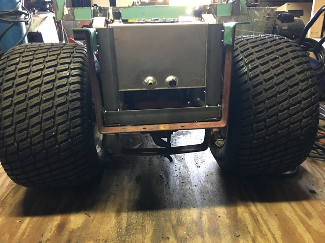

19richie66 16,942 #126 Posted August 20, 2016 Seat brackets and frame cut and tacked together. I have been trying to figure out how to dress off the tailend of this thing. Stood around and eyeballed the D160 grille I had laying in the corner. I had cut it and narrowed it 8", cut 2" off the width and removed the top headlight section and narrowed and shortened it about 2". I was going to mount it rightside up and put brake lights in it instead of headlights but I flipped it upside and decided the exhaust will come out where the headlights used to be. I will narrow the grille slats and paint them black. 5 Share this post Link to post Share on other sites

19richie66 16,942 #128 Posted August 21, 2016 Oh yeah. Plenty of room. Been thinking about how to do it. The pipe doesnt have to be big and I had planned on making a bezel to fit in there anyways. Just have to divide it into three sections. I'll get it out tomorrow and hopefully get it bolted up and get a better picture. Just have to find the right lights. 2 Share this post Link to post Share on other sites

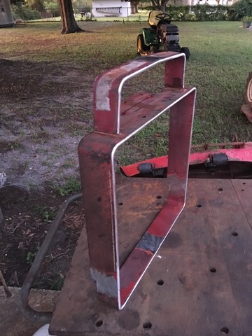

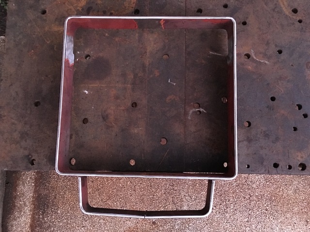

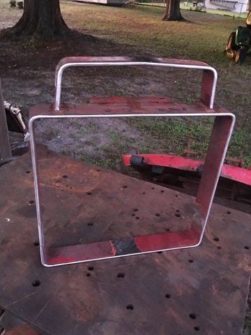

19richie66 16,942 #130 Posted September 10, 2016 (edited) Well I put the D-160 grille on a diet. Cut 1.5" off the total thickness, narrowed it and cut the height down and continued the bottom of the grille with the leftover diet metal to make it completely closed all the way around. Now it will get flipped upside down and mounted to the rear of the rat to dress off the tailend. Ill narrow some angle and weld it in th fill the opening like factory. It will swing out to be able to get to the fuel tank and lighting. Don't mind the homeless green thing in the background Edited September 10, 2016 by 19richie66 Fix photo 2 Share this post Link to post Share on other sites

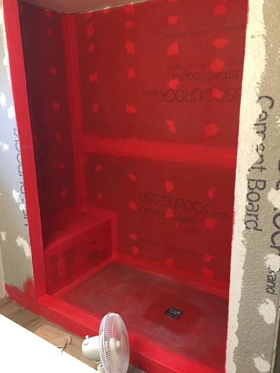

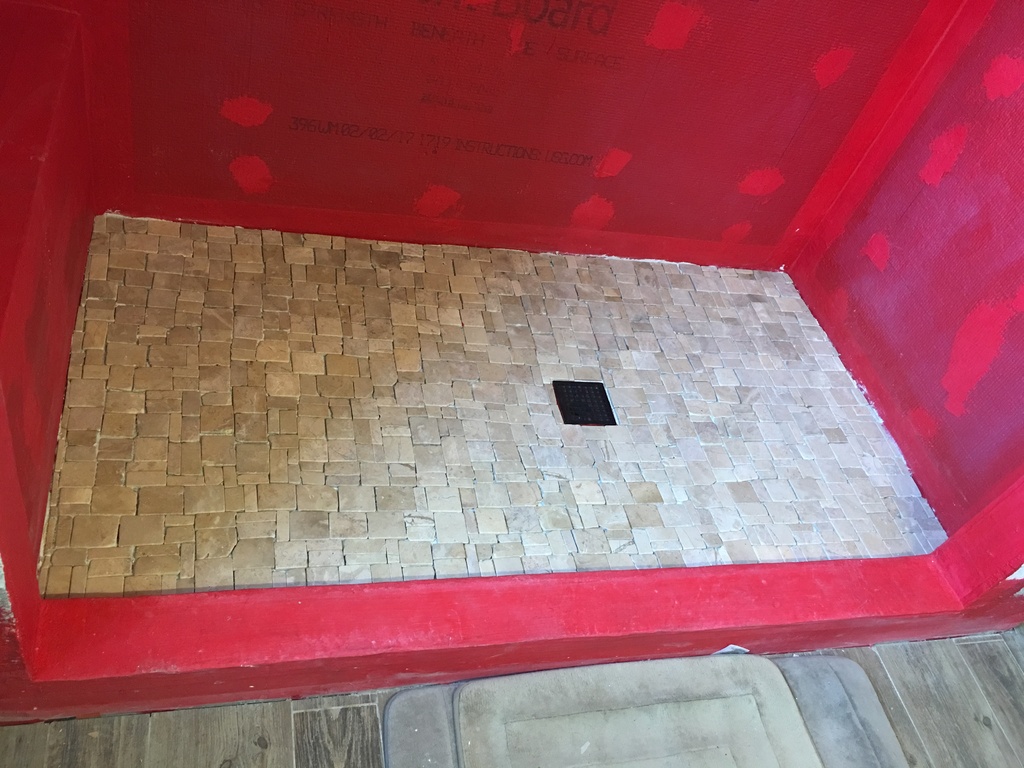

19richie66 16,942 #137 Posted July 3, 2017 Thank you john. I try. I get frustrated and have to step back for a bit. I have been working on this house more and more. Pretty much do it all myself. Thats why it takes so long, lol. Its kind of our retirement plan. Hope to sell it in a couple years and move to South Carolina. Master bath is almost done. I installed my new water heater last month, new central heat and air in January, then add on 40 hours a week keeping the Mouse happy and everything else along the way. Anyways, I am working on it again. Hope to be there next year with it. Pics of what I have been doing. At least it's the right color....... 6 Share this post Link to post Share on other sites

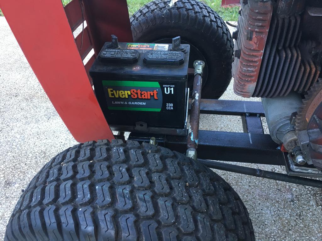

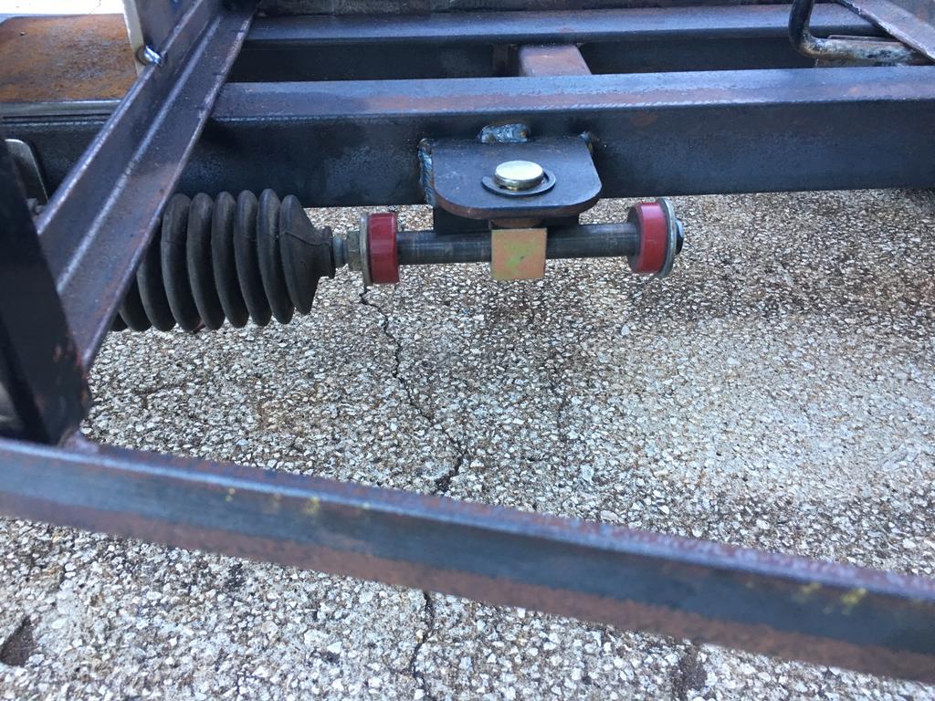

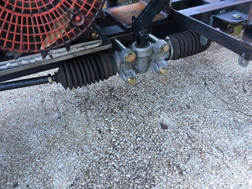

19richie66 16,942 #139 Posted October 15, 2017 Let's bring this back out of hibernation. Rolled her out today and redid the steering rack mount and made it simpler and cleaner than the bracket I had made earlier. Going to redo the way the floor is so I have been changing around a couple of things. Made my battery box and trimmed up the lower front hood hinge to clear it. Also made a L shaped bracket to weld to the firewall frame for support and the remote oil filter mount should bolt up there. Small steps....... I mean I have only started over twice and been working on it for 3 years now 7 Share this post Link to post Share on other sites
953 nut 51,680 #141 Posted October 15, 2017 If you were to hang a hydraulic pump on the engine you could make that a Power Rack and Pinion. 2 Share this post Link to post Share on other sites
19richie66 16,942 #142 Posted October 15, 2017 (edited) I have a hydraulic steering cylinder for an outboard and a power steering valve but I decided to keep it this way. It steers pretty easy anyways. Changed the name also because I had a decal made for the hood. Edited October 15, 2017 by 19richie66 4 1 Share this post Link to post Share on other sites
