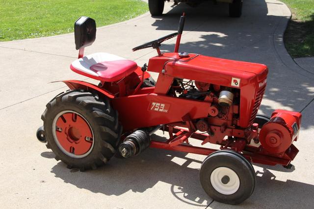

Here's a picture of my 753 pulling tractor.
post-3210-0-10785100-1406339887_thumb.jp
  • Like 1
So, when you are not pulling, it's set-up to supply aux. electrical power for working on the puller. NEAT idea! :ychain:
