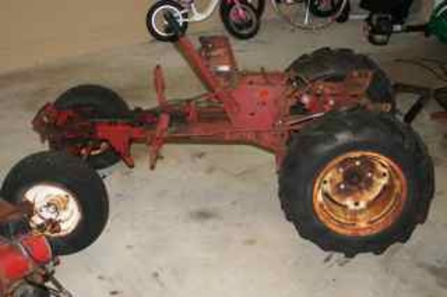

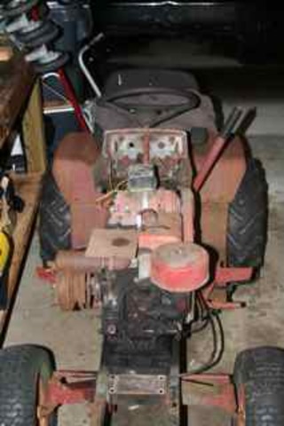

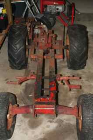

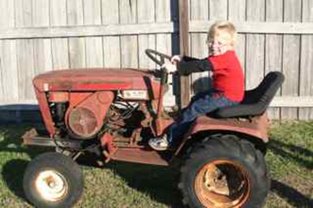

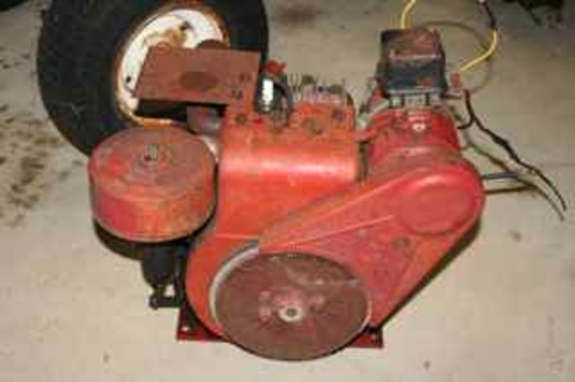

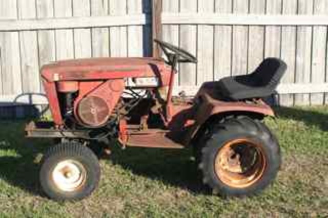

Hi my name is Chris and I purchased my first Wheel Horse two weeks ago. I have what I think is a 1974 WH A90 Special. This is a project for my self and my five year old son. My plan is to tear the horse down rebuild the B&S 8HP motor and getting everything back in working order. I currently have the tractor down to the frame and just need to take the tranny out. Motor runs but smokes, also I think I have issues with the tranny. When I spin one wheel while lifted the other wheels spins in the same direction.

WELCOME ! Nice little Wheel Horse you have there!! Keep sending us pics of how your project comes along....

Thanks to all for the welcome. Mike and Terry, when the wheels are off the ground and I spin one side the opposite side spins the same direction. I think they should spin in different directions, but thats just from what I am learning here. From what I can tell I don't think the transmission has been open before, but do not know for sure. The person I bought it from was just using it to move trucks around, so pulling and going in a straight line was ok for him. The other thing I noticed was that on each of the wheels instead of being flush with rim, the axel stuck out about 3/4's of an each. Thats on both sides. I am going to post this issue on the tranny portion of the forum, but any help that can be provided her would be great.
