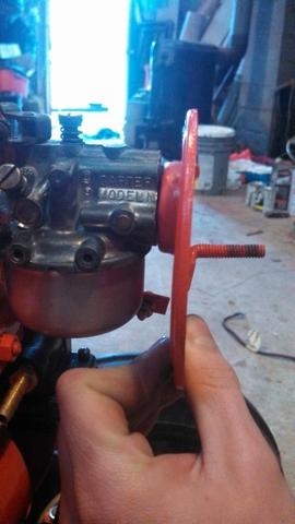

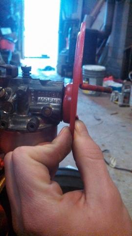

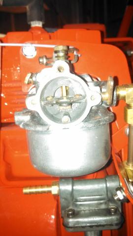

Which way does this go? It fits both ways so I'm confused. Also the air canal for the adjustment screw (top hole on picture number 3 on the carb )just sucks unfiltered air. Neither way covers up that hole. Is that right?

Turned down around so the longest part is on the bottom.
The gasket should cover the top hole.

The air cleaner base has 3 screw-mount holes in it (Left, Top, and Right).  Here is a pic of a 10hp Kohler engine carb with 3 matching screw-threads in it.  Simply match the base to the carb so you can put a screw into each of the 3 holes.

My plate only has two holes in it. So it will still get air and run right if the gasket blocks the hole? As you can see the air cleaner plate flange doesn't go up high enough to cover the hole so it would just be gasket material covering the hole..
rmaynard
The top hole is blind, unthreaded, and insignificant on that model.
