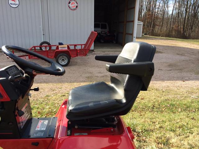

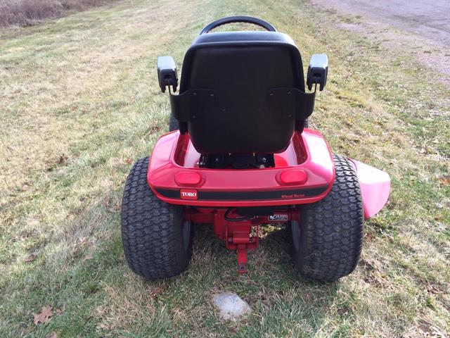

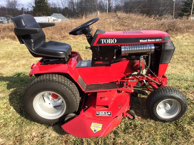

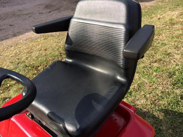

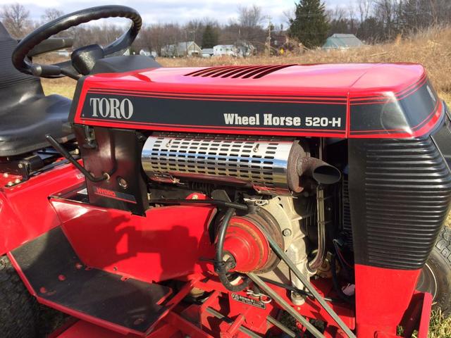

I bought the 94 520H that was listed on Red Square classified. Very happy with it. 350 hours. 48" SD deck. Should get years of use out of it. I have 93 520H with 980 hours. It is in fair to good condition. I can't decide if I should keep it for parts or sell it. It seems I've heard more bad than good things about Onan 20hp motors. I think the 93 520H tractor would be worth about $750-$850 with the 42" RD deck and mule drive. Feel free to post good stories and bad nightmares about Omen motors.....I mean Onan. I am curious.

Wow!  Looks brand new for a 1994!!

I think its a good motor but it needs more attention given to it than a Kohler. It should never be allowed to overheat/run hot! I also think if I owned one I would be installing the vented beltguard so that the heat from the rear cylinder could blow freely away from the motor.
I think someone on here was making a vented beltguard.

I saw the vented belt guard in a post about 1 1/2 years ago. I could be wrong but I thought someone posted not to change the airflow pattern. Is that why the valves go bad? do they overheat or something?

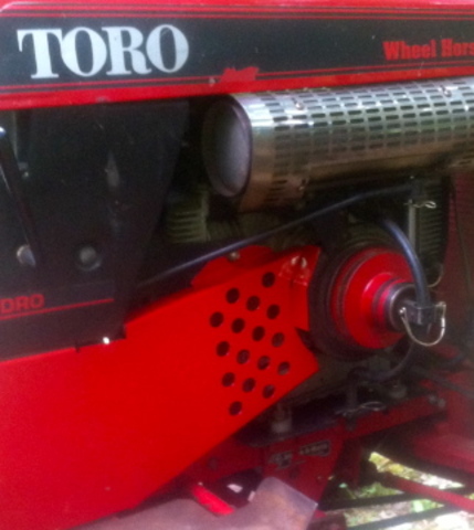

Air flow across the rear cylinder is blocked by the guard over the drive belt.  Like all safety features, I am sure this was added late in the design.
The front cylinder has nothing blocking the air flow.  The front cylinders never throw valve seats.
I wouldn't modify the tins that direct air flow to the fins on the rear cylinder, and I would be very fussy about keeping leaves and grass out.
This is what I have done to my belt guards.  3/4" step cut drill bit and a drill press.
LOTS of heat comes through these holes, most of it off the upper half.

I love the holes in the belt guard Cheesegrader. That looks like a simple after work project that I bet helps out a ton and will save a few Onans and 520's along the way. I see so many of these starting to get parted out. Makes me sad because there just isn't anything that compares IMO.
