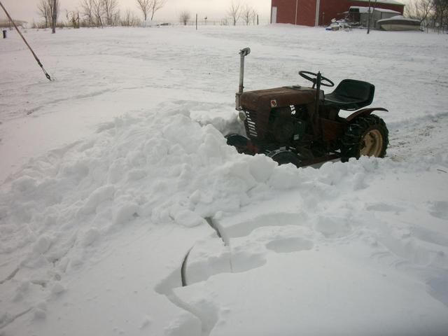

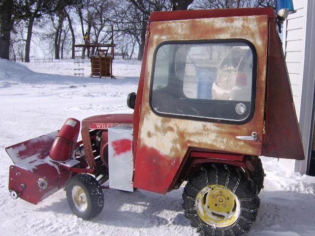

rydogg 186 #18 Posted December 3, 2013 (edited) I never have used weights but chains are necessary when the snow/ice start to get packed on my gravel driveway. My little 552 with the 5.5hp lauson can push through amazing amounts of snow with the 42 inch snow blade....I stopped to take this picture and got back on and drove right through this drift without any problem. My old C160 snow throwing machine had such a heavy cab I didn't need weights. These are old pics no snow here yet. Edited December 3, 2013 by rydogg 1 Share this post Link to post Share on other sites
