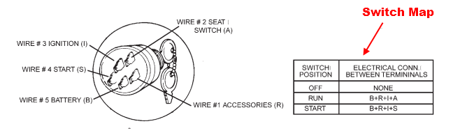

Save Old Iron 1,563 #36 Posted November 24, 2013 (edited) Yes, there should be a switch map on the schematic for tractor wiring. In the RUN position, the "B" and "R" terminals should show continuity. You should be able to measure continuity between the "I". "R" and "B" terminals. I don't know if you mentioned if the engine was a K series or a Magnum ... just another sanity check question. I could never understand how a 3 amp charge system could be of any benefit on a coil based ignition system that by itself consumes 3 amps. leaving no real energy to charge the battery in addition to run the ignition system. Unregulated 3 amp charge systems - I really dislike the concept. Edited November 24, 2013 by Save Old Iron Share this post Link to post Share on other sites
Save Old Iron 1,563 #37 Posted November 24, 2013 The switch map below shows all the pins that should be connected together in OFF, RUN and START positions. Share this post Link to post Share on other sites

Save Old Iron 1,563 #48 Posted November 26, 2013 The charging system is finally working. Replaced ignition switch Sounds right since you did not have any continuity between the R and B terminals - no electrical path for the charge current to travel from the stator to the battery. The metal shell of the ignition switch has no electrical connection to any part of the switch {in a coil based ignition system}. Share this post Link to post Share on other sites
Save Old Iron 1,563 #49 Posted November 26, 2013 Started engine and had 13.60 volts Went up to 13.75 in a couple minutes. Drove it around yard for a few minutes then checked again 14.20 volts. Another downside of the 3 amp unregulated system is the tendency to overcharge the battery. Most owners have experienced the battery voltage rising above 16 volts with the unregulated system. We will have to wait and see if the battery voltage climbs to and beyond 15 volts. If it does, the battery is either in need of replacement (has become sulfated with an high internal resistance) or will begin to degrade because of overcharging. You may have read the description from one of the chaps from England regarding the "balancing act" that is present in the design of the unregulated 3 amp system. If you remove the battery or break the connection to the battery, the output of the stator will rise. We just have not had any chance to experiemt with a 3 amp system to tell what the output voltage will rise to with an "unloaded" stator. Share this post Link to post Share on other sites
Save Old Iron 1,563 #50 Posted November 26, 2013 Maybe i did have a ground problem. The problem disappeared when you replaced a defective ignition switch with no conductivity between the two terminals needed to support the charge function.This makes sense. Not a "ground" issue as there are no "grounds" in or through a coil based ignition switch. The troubleshooting you performed by measuring the resistance between the R and B terminals showed solid evidence of an issue with the charge circuit. I did not see any real measureable evidence of a "ground" issue. Here is an easy method to check the quality of your ground connections. Set a DC voltmeter on the 20 volt range. Place the negative meter probe directly on the battery negative lug - not the negative battery cable terminal but the battery negative lug. Place the positive meter lead on any clean metal on the engine block. Crank the engine and note the reading on your meter. Any reading less than 0.5 volts indicates ALL the connections from the battery to the engine block are clean and intact. If you see a 12 volt plus reading, you have an OPEN connection in your ground circuit. Any voltage indication between 0.5 and 12 volts indicates some degree of degraded connection in the ground circuit. I intend to create a "voltage drop" troubleshooting tutorial to assist in locating exactly where the bad connection(s) exist. Shotgun methods of troubleshooting involving just unbolting ground cables and polishing the terminals does not assure you have done all you can to eliminate a "bad ground". What if the bad connection is the crimp of the termnal to the groiund wire copper strands? Cleaning the terminals does not resolve the issue. Making a measurement on the voltage drop across the cable will indicate where the issue resides and does away with the shotgun methods that cost money and waste time. 1 Share this post Link to post Share on other sites
