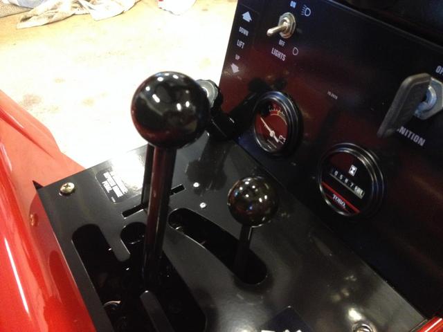

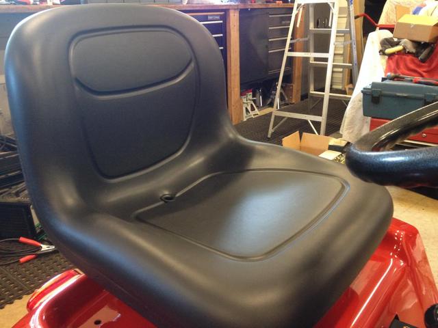

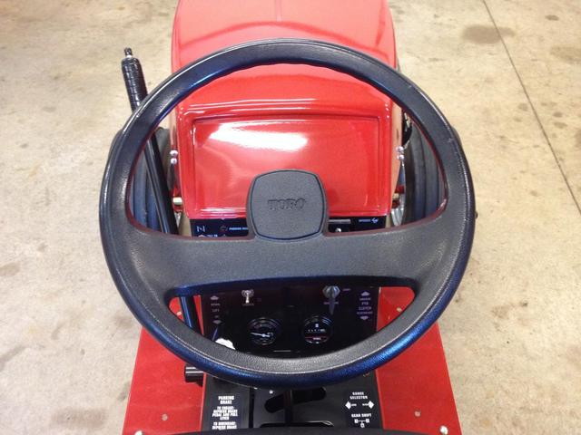

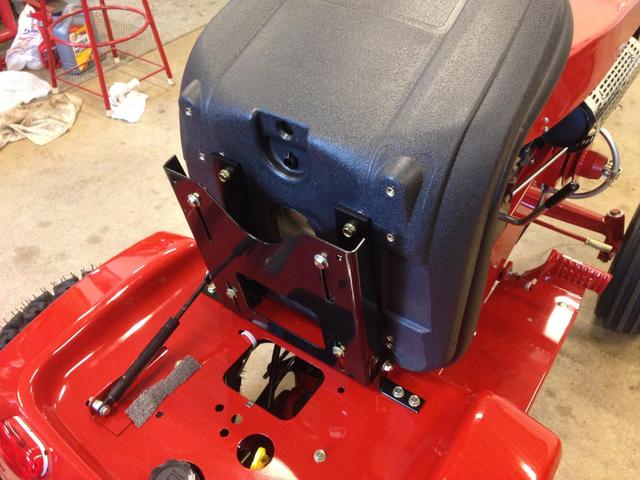

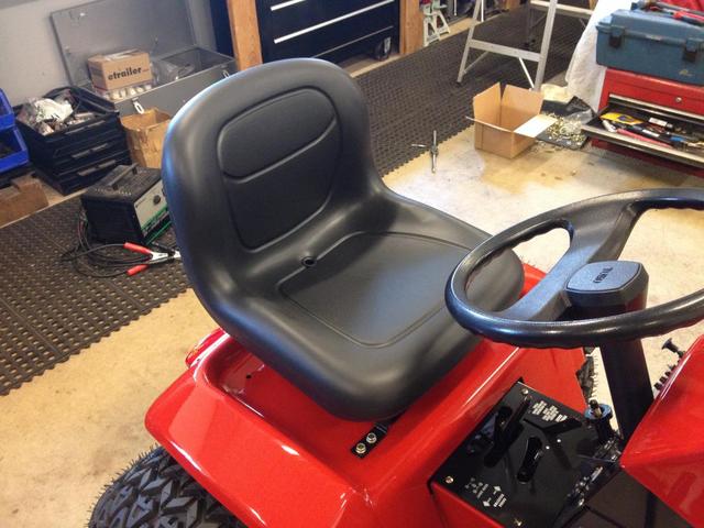

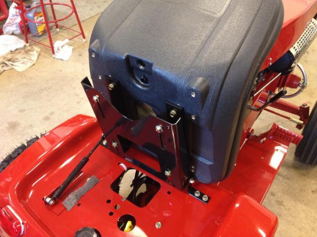

Martin 2,130 #402 Posted June 19, 2014 (edited) took the steering wheel off #1 and cleaned it up to use on #3. out of the three i have this was the nicest one. came up nice enough, few spots where the wheel is worn and a few little nicks from use over the years. seat came today as well. i went round and round about what seat i would use on this one. i really wanted an original year seat, but i also wanted something new as well. i have had a few different styles of seat, the michigan ones I've used for a few years now, the v3500 is my favorite of them..... and this one i used on the c125, a KM 160 unipro seat...... for the 416 though i wanted some thing that looked a little more 'modern'. i liked the look of the mid height toro seats on the new zero turns, but the price at $175.00 was a little out of my budget. KM manufacturing make a seat the same but without the toro branding on them, this one also has a drain that the toro one doesn't. i liked the mid height seat (15" high) more than the 18-20" high seats that you sometimes see used on these tractors. the mid height seat is a KM 123 unipro and was a more reasonable $91.00 shipped from www.turfseats.com (KM manufacturing web store) i fitted the seat today, it has multiple fitment including the 7.5 x 8 that the later WH tractors have. its getting harder to find that bolt pattern, the 7 x 7.5 is far easier, and i didn't want to be messing around to fit it. the only down side that i can see is all of this style seat is a plastic base. we will see how durable it is. heres how it looks on the 416.... KM seat but Milsco branding....... i cleaned up the shifter knobs as well. the surface was well weathered and the smooth finish was long gone. i rubbed them down with 220, 400 and 600 and clear coated them with some rattle can rustoleum. came out nice and the speckled finish they had from weathering seemed to disappear once the clear went on. i thought i would try it and see how they turned out, i think they will stay for a while....... before..... after.... Edited June 19, 2014 by Martin 3 Share this post Link to post Share on other sites

Martin 2,130 #404 Posted June 19, 2014 I like your solution to weathered shifter knobs. I hope you don't mind if I "borrow" your solution for my C141. I already picked up a couple of improvements along your journey that I have implemented on my 314. Don, i went back and forth about purchasing new knobs, either from Glen here on the forum, or even Toro. they are between $6-$8 ea depending on where you get them. there are also other online places that sell them cheaper, but by the time you factor in shipping they are roughly the same. I've never tried to refurbish the knobs before and read up a little on bakelite and phenolic plastic restoration. the problem when it ages and the nice surface wears off is the wood dust that makes up the core of the part gives it a brown finish. when you sand the surface to get the weathered look off it most of the black comes back but there is now a brown or tan speckled finish from the composition of the material the knob is made from. i wasn't sure if the clear would 'disguise' this finish or not, but i was pleasantly surprised when they turned out looking like they do with the clear applied. i could also polish the clear after it has cured out and see how it looks, but for now they look good...... Share this post Link to post Share on other sites
dclarke 4,011 #405 Posted June 20, 2014 I can't wait to see the decals on this, Martin..... And in my opinion, you picked the right seat. 2 Share this post Link to post Share on other sites

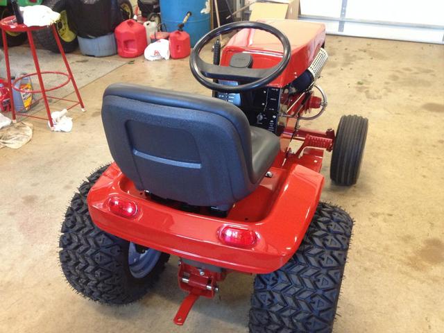

Terry M-(Moderator) 2,125 #406 Posted June 20, 2014 (edited) Looking very Nice Martin!! I really like the aggressive style rear turfs !! Edited June 20, 2014 by Terry M 2 Share this post Link to post Share on other sites
leeave96 487 #407 Posted June 20, 2014 Martin, The new seat looks great! How difficult is it to remove the steering wheel? What's involved? Thanks! Bill Share this post Link to post Share on other sites

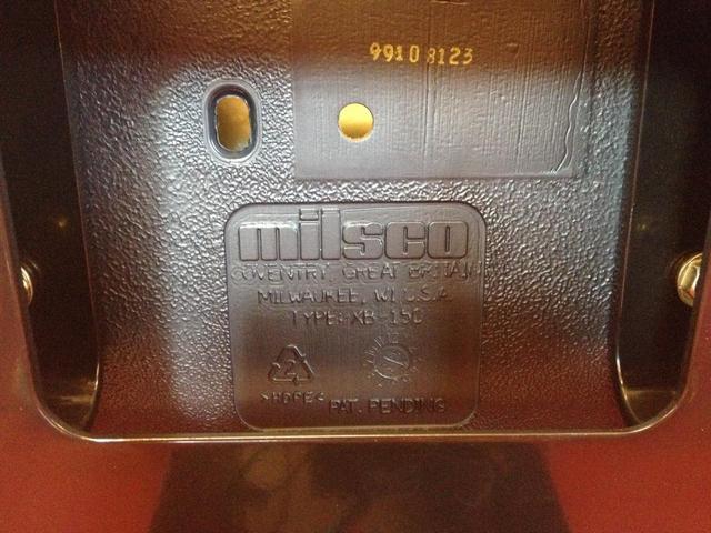

Martin 2,130 #408 Posted June 20, 2014 (edited) Bill, steering wheel removal is easy, or should be. There is a roll pin holding the wheel to the shaft, punch it out and should be as simple as twisting and pulling the wheel off. The pin position is in the pic below..... The pin has been removed and you can see through the hole that it goes through.... Here's one from above with the pin pushed out enough to remove the wheel. Sent from my iPhone using Tapatalk Edited June 20, 2014 by Martin Share this post Link to post Share on other sites

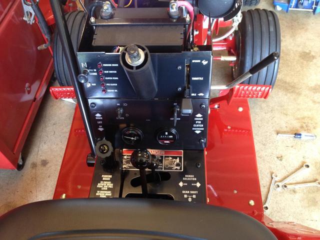

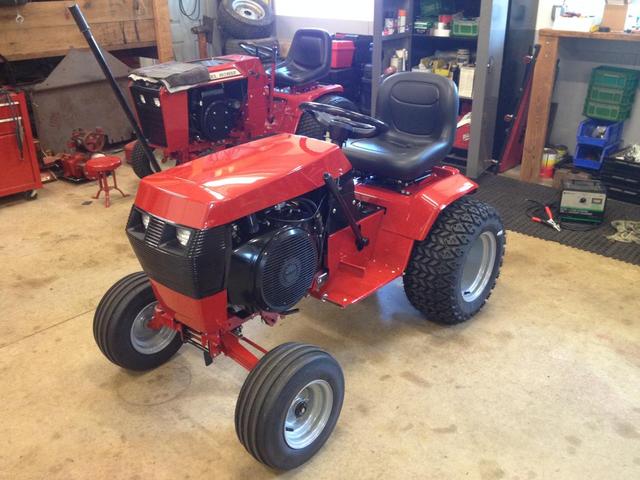

Martin 2,130 #410 Posted June 22, 2014 now that the seat is on theres only one thing left to do, seat time....... took it out and drove around the neighborhood for a good hour tonight, not sure if i was making the neighbors go nuts or not, because i was too busy enjoying the ride....... sorted a few minor things and found some others that will need fixing, biggest issue was the shifter is not central in its gate when in gears and just slightly touches the sheet metal cover. that will involve removing the covers and fixing. i will be removing the upper dash and covers anyway when i get the final dash decals from Terry so that can wait till then. also the parking brake lever isn't in the middle of its slot anymore and will probably need to be repainted as one side is scraped from touching the side of the slot. I think right now, i have a few fasteners that need to be swapped out for yellow plated ones, the decals need to be created and applied, hood catches need to be riveted to the hood (i just have small screws and nylock nuts holding the catch on right now), and a few other small things I've got written down somewhere need to be fixed, along with the shifter fix and i think it will be good.... after i had my fun riding around i brought it back and did a video of it......... 1 Share this post Link to post Share on other sites

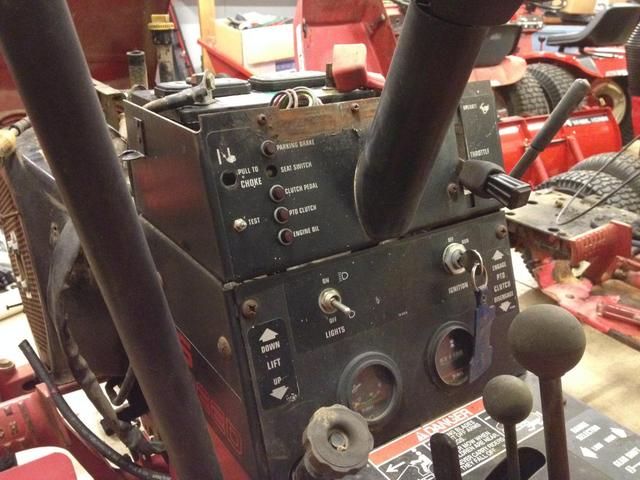

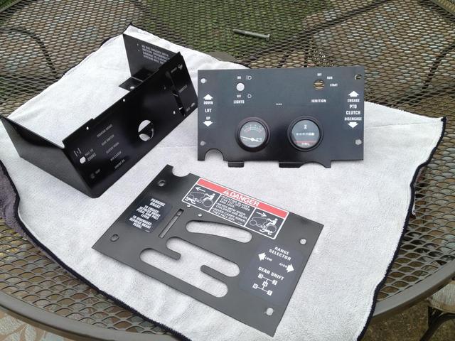

Martin 2,130 #420 Posted July 12, 2014 sometimes if the bolts are well weathered its better to go new. i like the original markings on a lot of the bolt heads and on this one the majority of bolts were well preserved, so it made sense to just replate. i had a lot of bigger stuff and brackets to do as well. thanks for your comments on the thread....... thought id update a little. the dash decals are mostly done now and installed. i had some issues with the upper dash that needed to be sorted, took a while to get a good enough method for installing so that everything lined up. I'm learning and the more i do the better the results. the biggest issue and hurdle to overcome with these are they are not laminated. they are very hard to apply and get perfectly right (or good enough to look at without turning away....) you only get one go and once the decal is stuck, its done... they don't stretch very much, they are very hard to get bubbles out of compared to the laminated decals that Terry normally does. if you find an issue with a bubble or out of position with the standard ones, you can lift them up and reposition or whatever without stretching the decal. the main reason i went with this style of decal is i liked the matt look of the decal vs the glossy look of the laminated ones. they also better match my black on the dash and i think they blend in very nicely. I'm going to used powder coated screws and ignition/light switch nuts, washers so they blend in with the dash and don't look so distracting compared to the yellow chromate fasteners. the smaller decals are easier to apply and get right without bubbles and bumps etc. another thing that makes these difficult to apply is they are going on powder coat which has some orange peel and also the steel is far from free of defects. i ended up sanding the powder on the face of the upper dash so that the decal had a flatter surface. here they are!!! Share this post Link to post Share on other sites

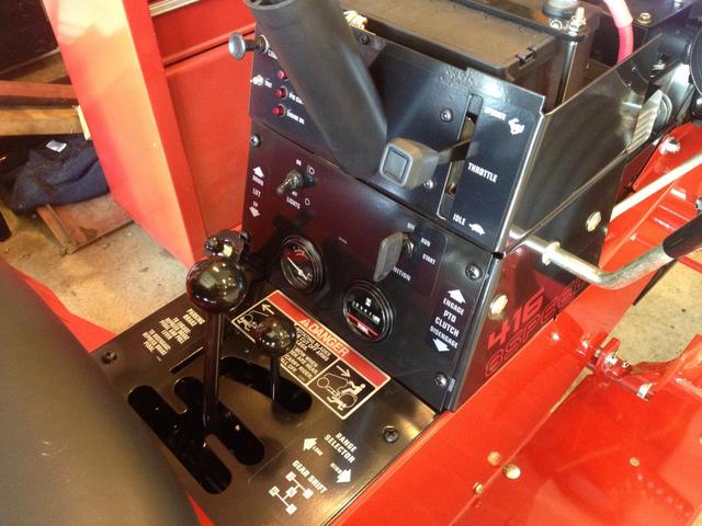

Martin 2,130 #425 Posted July 20, 2014 Alright, having a hard time finishing up all the little things on this one. residing the house and work is getting in the way of working on it. got a few hours this morning to finally get the dash all back together. i wanted all the fasteners to be 'hidden' on the dash so i powder coated all the screws matt black that hold it all together, also the nut that holds the ignition switch on and i found a boot to cover the light switch. i am happy, its the look i was after and all the decals blend with the black and i think it turned out great..... i also added a new throttle knob and slip over cover for the brake release....... thanks for all your extra time on the decals Terry, you gave me exactly the look i was after..... 5 Share this post Link to post Share on other sites
