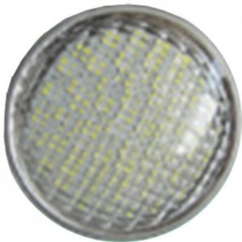

dbartlett1958 96 #4 Posted June 4, 2013 I put some of these in my 416. I can't remember where I got them, but did a lot of surfing to get the best price. I had to make a short pigtail for each terminal so as not to change the original wiring harness on the tractor. They work very well, the only issue I see is that they stay cool and snow does not melt off them when using the snowblower. These are PAR 36 9 watt LED's with Screw terminals instead of Spade terminals. Share this post Link to post Share on other sites
DotheDoo 15 #5 Posted May 20, 2014 They sell the PAR 36 9 watts on Amazon for $25 each. That is cheaper that buying a new square lamp with LEDS which are $75 for the pair. 1 Share this post Link to post Share on other sites
