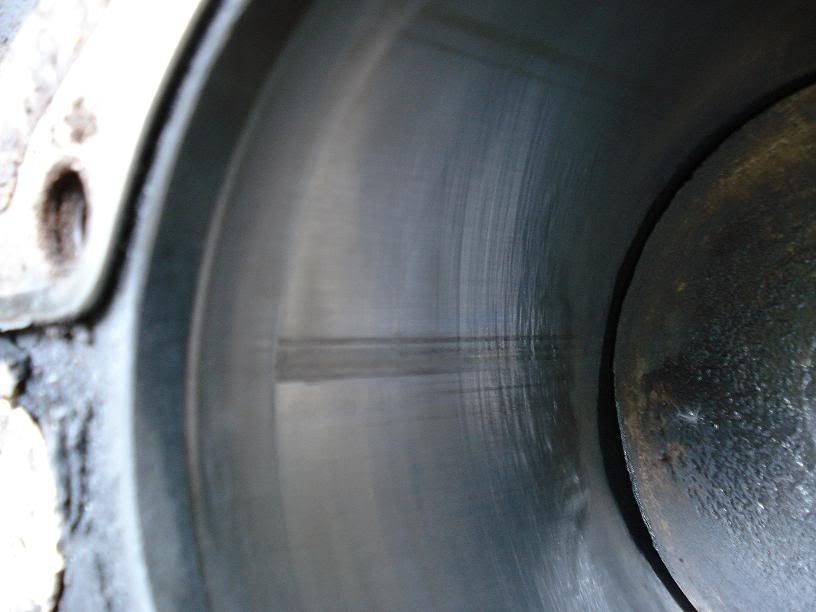

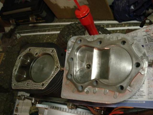

Anglo Traction 759 #13 Posted June 21, 2013 Bit late to this thread, but I also agree that De-carbon and Oil Consumption increase is a Myth. Carbon is a danger to your engine in several ways. Here is an example on the Engine I purchased as a replacement and found this....All caused by Carbon breaking off around the exhaust valve and it stalled the piston on the upstroke damaging the top edge- Needless to say I had to fully re-bore and rebuild this one, but the Carbon was mountainous around the Exhaust Valve and must have been glowing when the engine was running. I always find pre-soaking the carbon deposits to loosen then off works well and only needs a piece of blade shaped wood to clean it all off. If you can get it like this, it's well worth doing and will run nice afterwards- 1 Share this post Link to post Share on other sites
Fordiesel69 199 #14 Posted June 21, 2013 That picture is exactly what I don't want to have happen. Once this gouges out, the top ring will just burn up. Share this post Link to post Share on other sites
