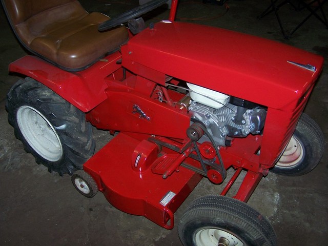

I don't know about the Majic paint . I use Van Sickle paint from a local farm store. There is one thing no one has mentioned here. When you add the hardener do you let the paint sit for about ten minutes before you add thinner? That is what you are supposed to do with the Van Sickle. As far as the gun you use, I use a touch-up gun from Harbor Freight most of the time and have never had orange peel. When I mix I add a little lacquer thinner so it runs easily off my mixing stick. I will usually only mix about 8 oz. at a time. You should spray an old piece of metal before you spray your parts to make sure you're good to go.
This is how mine look with the above cautions.
