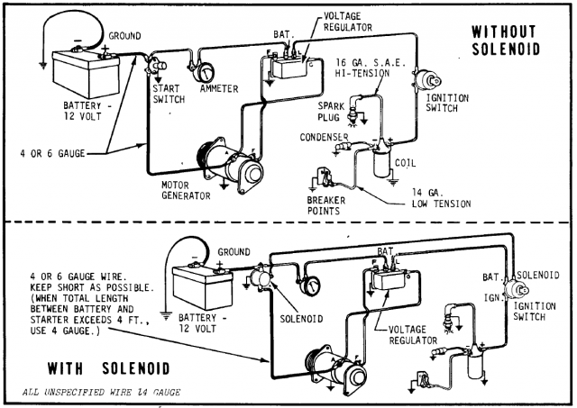

Hello i have problem my generator i don't know is wrong wiring or my generator is broken... when the motor run i have 13 volt in the bolt A (starter bolt) and Bolt (F) i have 0.6 volt is good or is bad ? maybe my regulator is broken but i don't know how to test regulator. post-9734-0-40151400-1363226390_thumb.pn

Dany, do not worry about the voltage at Bolt F.
When F is grounded by the regulator, the generator produces full output - should be over 15 volts at full engine speed.
When F is not grounded by the regulator, the generator produces no power.
A good test to see if the generator is working is to use a jumper wire to ground the F terminal when the engine is running. The voltage on the battery terminals should rise above 15 volts. Remove the jumper when the test is complete.

ho yes thank Chuck ! i make test and the problem ridiculous the generator run to slow and the regulator not run correctly. the regulator wait the generator produce 12.5 volt before to run correctly ! i replace link to carburetor to mechanic link.

Yes my problem is resolved ! i disconnect batteries  and motor not stall !
the engine runs too slowly because the link to carburetor was broken i replace wire to mechanic link to carburetor.
now the engine run very fast and the generator produce 13.5 volt when  the motor run to maximum.
the bolt F run correctly.
the bolt A run correctly.
