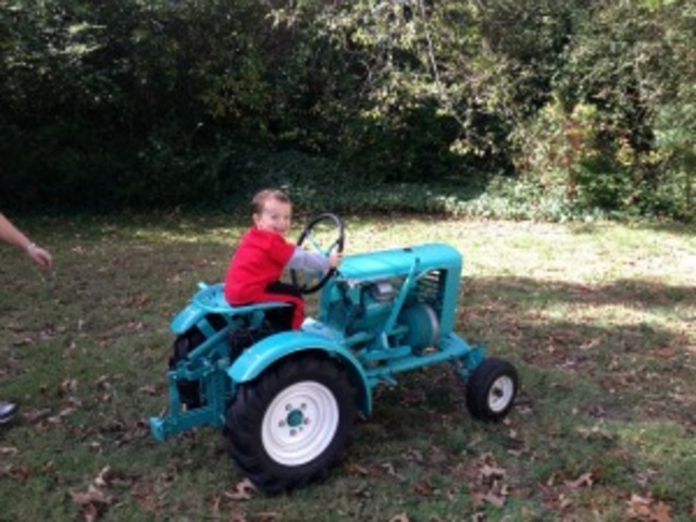

I need some help and advice. Just picked up this Commando 7 and I need a little help. I got this one the other day and I would like to do a partial restoration for my 2 1/2 year old grandson. The model number is 1-4751. The serial number is 669468. From what i found, it's a 1970 Commando V7, 4 speed, with a tecumseh engine. I only have the model number for the engine which is SBV-197. Is this the correct engine? Does anyone know where I can get parts for this lawnmower? Below is a pic of the Wheel Horse and one of my grandson driving my wife's Panzer.
Thanks!

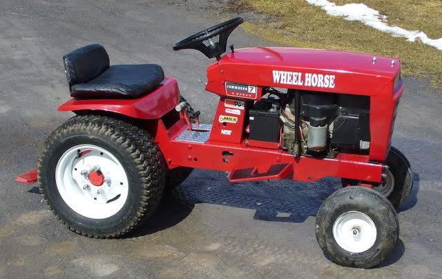

I had one given to me years ago by a friend who was gracious enough to flop it on my truck with the manure loader on his M Farmall. :thumbs2:
My son claimed it as his, so I stretched the frame, reworked the grille, installed bigger rear tires/wheels, and added a 12hp B&S engine:
