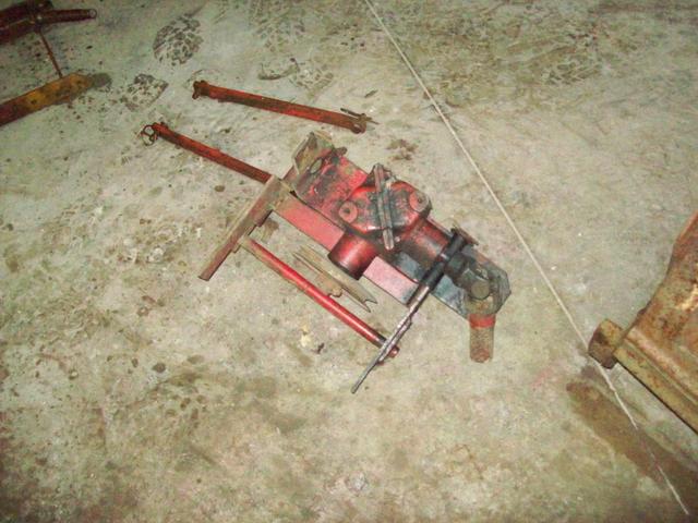

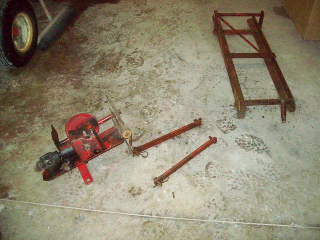

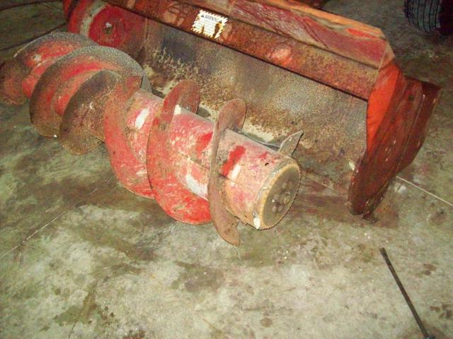

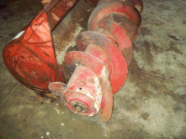

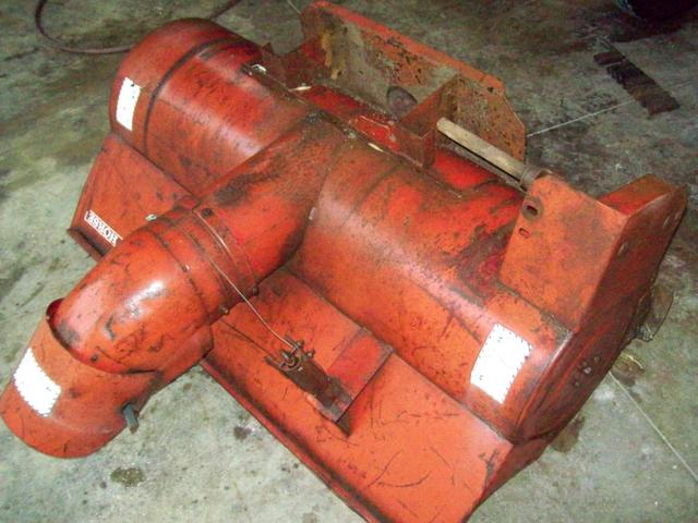

Started working on getting the snow blower ready for use. It's a little rusty but nothing through(no holes). Does need a few new parts and any help finding these would be great. For starters I need the 2 auger bearings and the drive belt. The chain and sprockets are good and the drive shafts are good also. Checked gear box for grease and it's full and in good condition. So all in all I believe the blower to be in good condition just need to replace parts mentioned.

John, I rebuilt one a while back that is now the "Vermonster". I don't remember the bearing numbers but if you take your old bearing or just dimensions to Auto Tech, they will get you hooked up!
