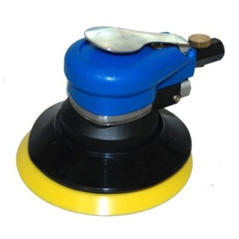

JimmyJam 516 #15 Posted December 9, 2012 Looks like you have a good start on the restoration! Not to ask stupid question, but what is DA? 1 Share this post Link to post Share on other sites
AMC RULES 36,945 #16 Posted December 9, 2012 (edited) Dual action sander. Edited December 9, 2012 by TWENTYHORSETWIN Share this post Link to post Share on other sites
