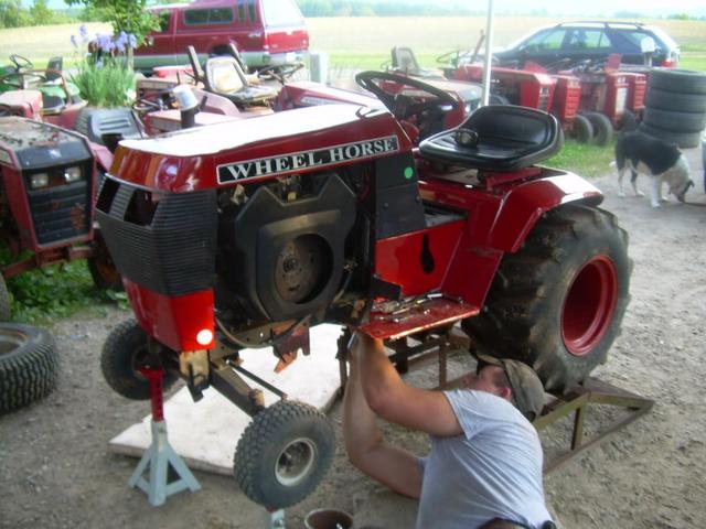

The one we used was a 20hp model onto a 312.
Problem with taking a "pulling engine" to use on a mower is all the work to get that 30hp out of it makes it real easy to over heat and blow up. Your looking at head work, offset boring, cam change, carb work etc. Worked pullers usually only run for short periods at full speed and then get shut off
Duane
Not a great picture but shows the engine in it
Thanks for the photo and the advice Duane.
