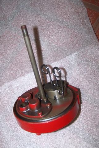

Is there any reliable sources for the HY-2/3 return spring? I see the "new and improved" style as used on the 1054 and cub's hydro unit but none of the older "upright" style available. Any suggestions?

I am contemplating converting my hy-2 spool and plate to a 1054/cub style so I have access to springs. Have any of you tried this yet?

I have not made the change in a 1054/1054- A hydraulic pump like you are contemplating but I had the same thought when I repaired two Hein-Werner pumps last year.
The old style return spring on legs and the newer style butter-fly wing spring have different setups in the cylinder that is in the hydro pump housing for the hydraulic fluid.
Some of these photos I took may help you or others that would be interested in this.
I would encourage you to take lots of photos of a rebuild and any changes you make we would all appreacaite learning about!

Photo of two of the newer version springs for the 1054 and 1054-A standard Hein-Werner pumps:
More 953 old style and early HY-2 Hydraulic Pump used on the 953 Wheel Horse Garden Tractor (Serial No- 62-580). The Hein-Werner Hydraulic Pump Metal tag lists the Model No. as A-4 00WH and the Serail No 1305.
Also here is another variation on the Hy-2 pump that was only used in the very early models of the 953 Wheel Horse tractor. This came off of a tractor we have that is (Serial No: 62-580).
NOTE that the handle is not flat like all the other 953/1055 and 1054-A's that I have seen - it is a round rod and extends out past the housing. Also the container or housing for the fluid and spring and cylinder is wider by about an inch and a half in this photo.
The port for refilling the hydraulic pump is also on the end of it and built into the housing unlike the screw in port that was in the middle of the housing on later models.
When installed on the tractor, this pump has a rounded frame covering the pump housing that was molded into the left side tractor frame guard where the clutch/brake pedal is located.
Photo of longer cylinder and the port for refilling with the cap off:
A good photo of the whole pump:
So...to clarify, am I correct to say this type spring is the most difficult one to obtain.
When searching for another one...which type is this spring known as...is there a part number assigned to it we should be looking for?

Aside from fabbing up your own...does anyone know of a source for another of this type?

That is correct Craig . Part No 4837 in the May 10, 1963 Wheel Horse 953 Manual.
