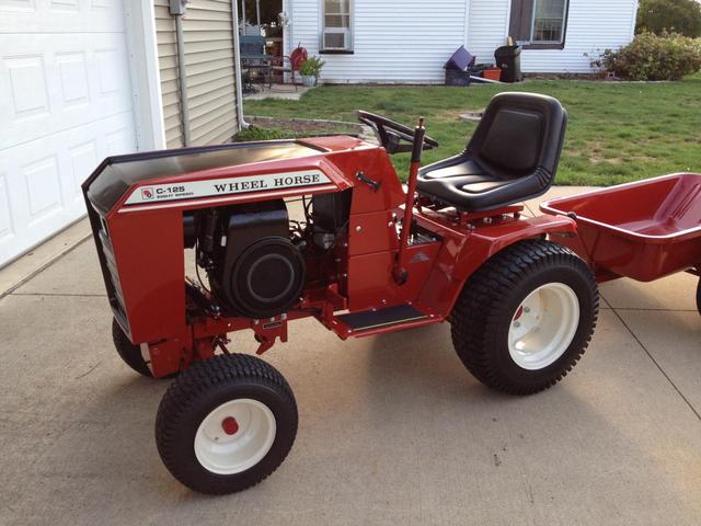

Martin 2,130 #152 Posted August 23, 2012 almost done, lots of small stuff finished off and as soon as the decals are on i will post a few pics of it finished....... for now i just wanted to just post this one to silence the skeptics........ 1 Share this post Link to post Share on other sites
bowtiebutler956 649 #153 Posted August 23, 2012 OK Martin, I've officially been silenced! I won't talk any more trash about your Horse blankets, at least not on this one. The seat looks Fantastic, and comfortable. So, how's it feel? Matt :flags-texas: Share this post Link to post Share on other sites
Martin 2,130 #154 Posted August 23, 2012 the seat feels fantastic, happy i went with this one over my favorite michigan v-3500 smaller seat...... oh, i also drove it around for at least 30 minutes tonight, and it runs and drives awesome. that hydro drive pulley really gave it some legs as well....... overall i couldnt be happier how it drives, very smooth and quiet. jeanine even got 15 minutes on it too....... Share this post Link to post Share on other sites
bowtiebutler956 649 #155 Posted August 23, 2012 the seat feels fantastic, happy i went with this one over my favorite michigan v-3500 smaller seat...... oh, i also drove it around for at least 30 minutes tonight, and it runs and drives awesome. that hydro drive pulley really gave it some legs as well....... overall i couldnt be happier how it drives, very smooth and quiet. jeanine even got 15 minutes on it too....... That's great news. Does it pull nice wheelies with the new pulley? Matt :flags-texas: Share this post Link to post Share on other sites
Martin 2,130 #156 Posted August 23, 2012 well, i havent really tried after the first time letting out the clutch in top and it nearly threw me off the back (before the seat was on there, with just the blanket!!!) it definitely gets going from standstill in a hurry. i think the gearing is perfect. reasonably quick in top but still slow enough from what i can tell in the lower gears. best of all the standard belt guard fits without mods and a stock hydro (from these years) belt is perfect length.... Share this post Link to post Share on other sites

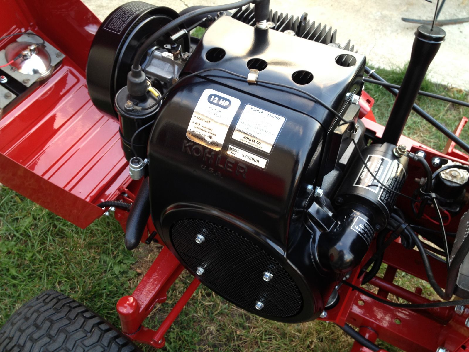

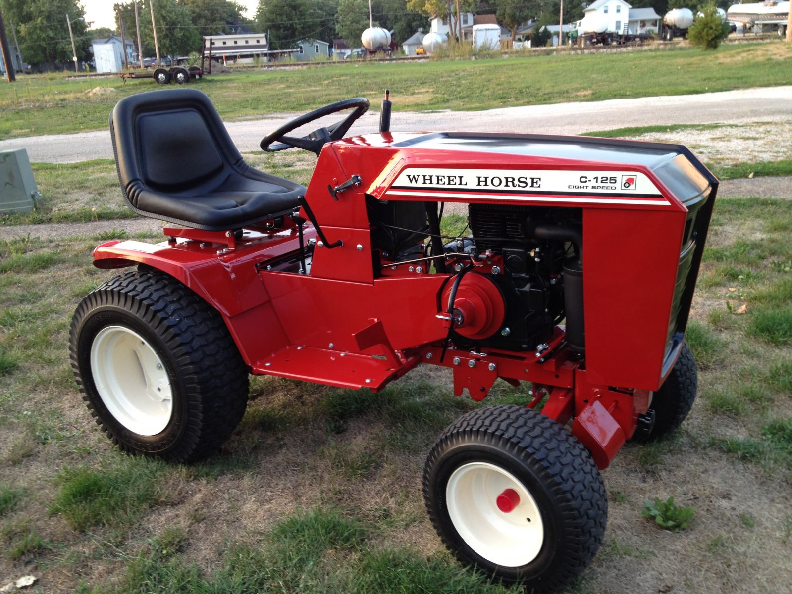

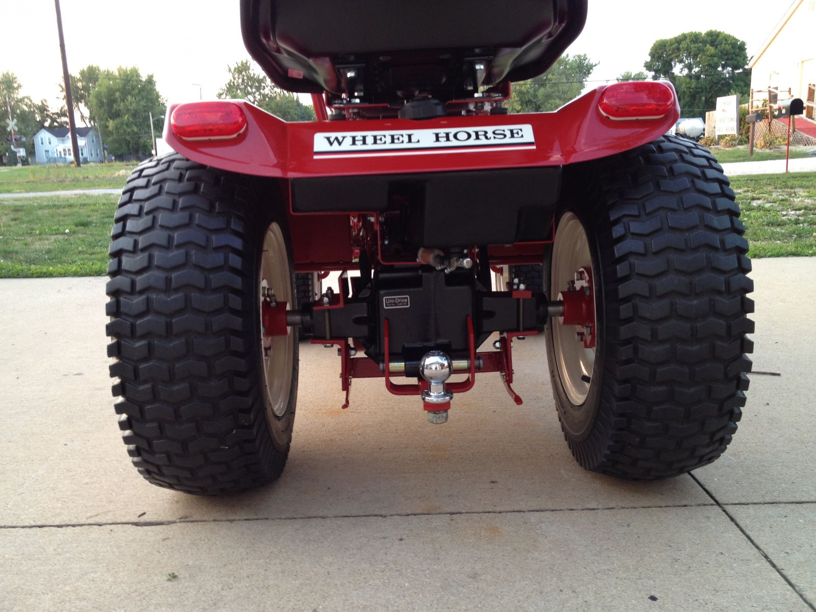

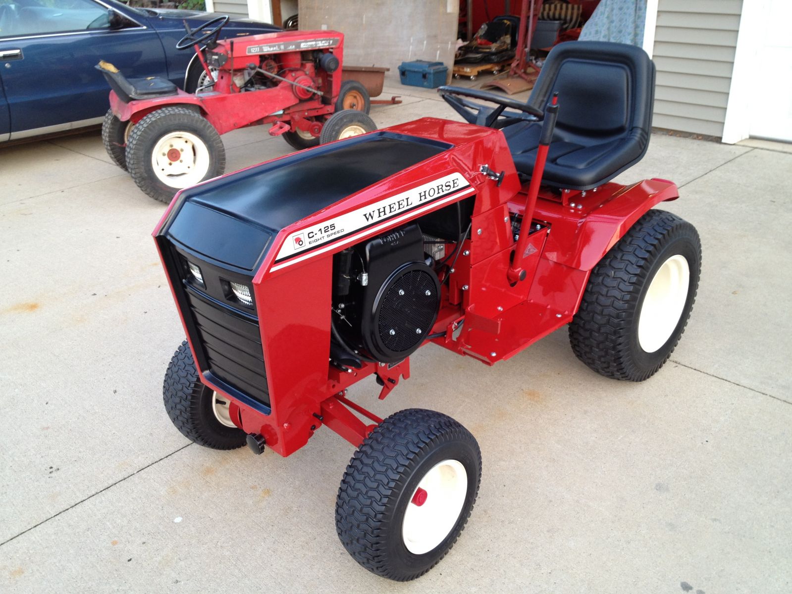

Martin 2,130 #159 Posted August 25, 2012 got the decals from terry today. thanks terry, they turned out very nice. changed a color or two around a little to more suit my taste, the white in the large decals was done linen beige, the engine decals which are normally red and white on the red engines, i wanted done in black and silver for my black engine. i still need to make up a template for the front hood decal. this has a large logo decal with the border around it being a 1980, i think 1981s were the same..... ( i havent forgotten about you, jachady, terry and i should be working on the hood decal early in september) anyway heres the pics of it all done, other than the foot pads on the running boards and a few little things that arent right yet...... maybe a vid of me riding a little, might be a little while uploading though, the bandwidth sucks on friday nights...... all these pics can go big if you want to see all the detail rough bits....... i think its now time to put it to work and get it dirty...... :woohoo: 1 Share this post Link to post Share on other sites

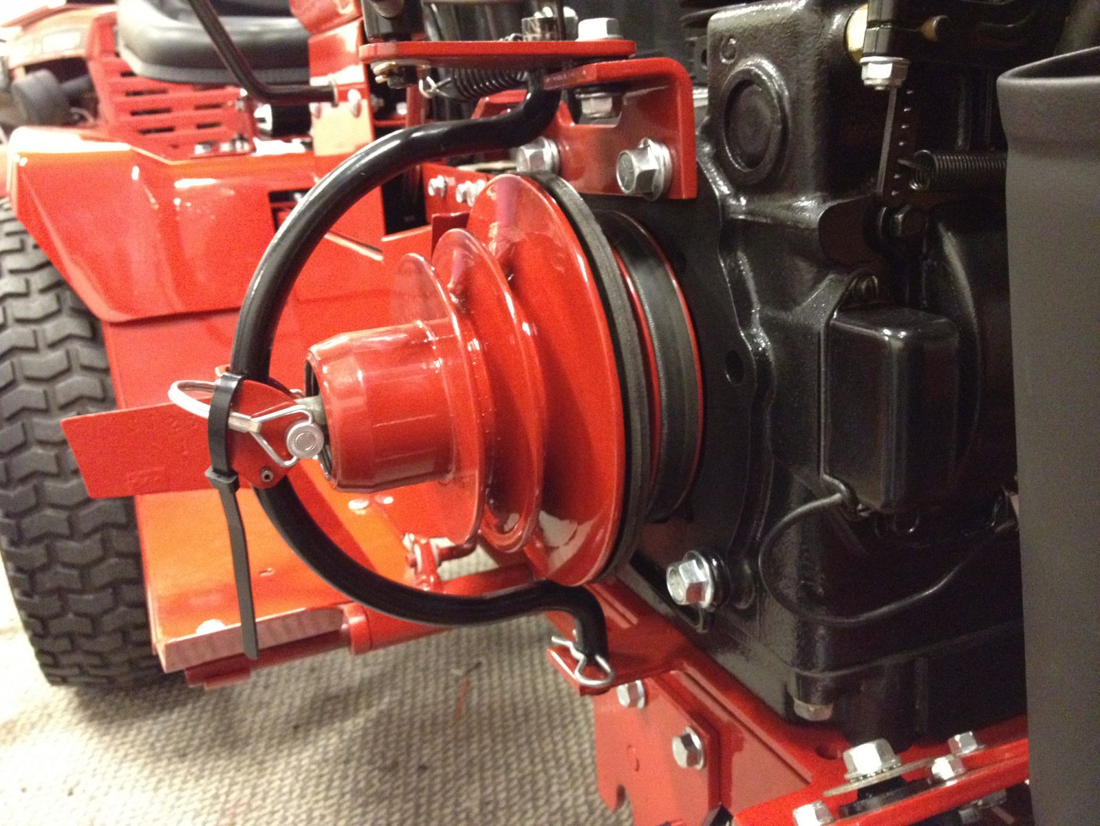

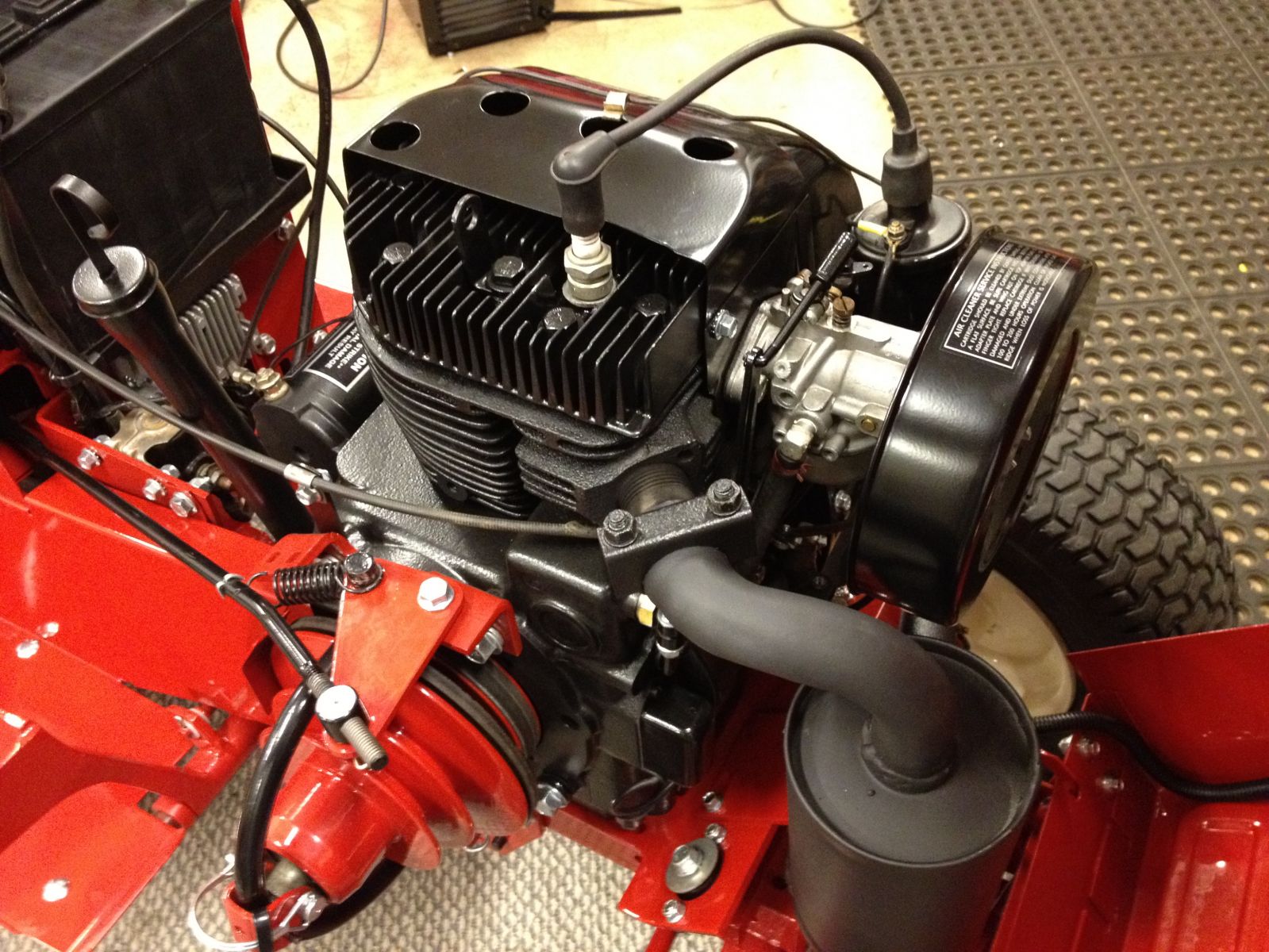

Martin 2,130 #169 Posted August 25, 2012 Jake, I've thought about changing gearing (pulleys) for a while now. I wanted to do the 1057 as the gearing on those year tractors is pathetic for top speed. The hydros are a lot better but the mechanical trans with that small engine pulley is just slow. Kent and Jeanine left me in the dust at Charlotte. So with the c125 it was a given that I would do it. The belt guard is suitable for both the mechanical and hydro drive pulley sizes and the belt for the hydro tractors is the right length for this mod. The engine pulley was a 7466 and I replaced it with a 7443. The drive belt was a 7473 and I replaced that with a 7478 (stole it off my c160!) Share this post Link to post Share on other sites

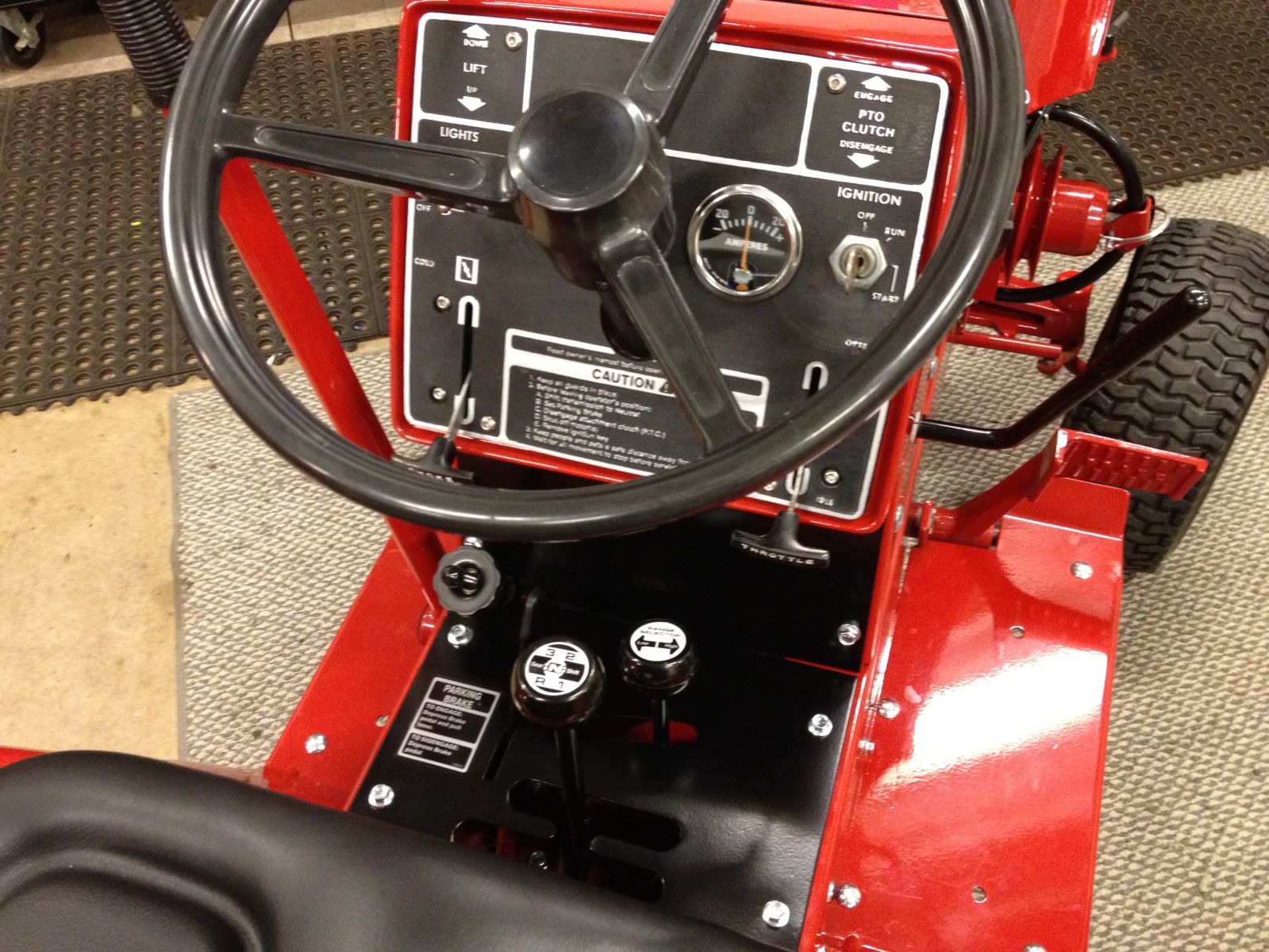

Martin 2,130 #173 Posted August 29, 2012 got the foot pad grip thingys on tonight. purchased some non slip stick on stair tread stuff from lowes and cut it to fit. it comes in a 6" x 24" piece and i cut it in half to give me 2 pieces 6" x 12" and then trimmed the corners to match the other rounded ones by using a large socket with the same radius. i also had to clearance around a carriage bolt on the running board that was in the way...... Share this post Link to post Share on other sites
bowtiebutler956 649 #174 Posted August 29, 2012 got the foot pad grip thingys on tonight. purchased some non slip stick on stair tread stuff from lowes and cut it to fit. it comes in a 6" x 24" piece and i cut it in half to give me 2 pieces 6" x 12" and then trimmed the corners to match the other rounded ones by using a large socket with the same radius. i also had to clearance around a carriage bolt on the running board that was in the way...... Thats the exact same stuff I used on my B-80, but I cut from the yellow stipe over off. I didn't like the yellow, but it looks pretty good on yours! Matt :flags-texas: Share this post Link to post Share on other sites

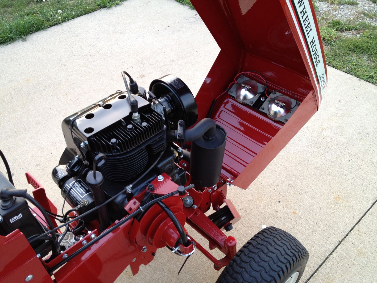

Martin 2,130 #175 Posted August 29, 2012 matt, i thought about just getting the plain skateboard grip tape that ive used before, but ive seen the yellow on other blackhoods ( i think kellys son has the yellow on his c145) and i liked it. heres another pic...... Share this post Link to post Share on other sites
