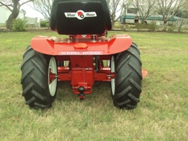

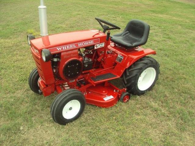

:WRS: Jamie! Sounds like your getting it beat. I recently had my trans apart in my B-80, but mine is just a 4 speed. If you get a chance, post some pics. :wwp: Here are some pics of mine, you can still see the blue silicone between the case halves, because I didn't feel like waiting on a new gasket. :ychain:
Matt :flags-texas:
Matt :flags-texas:
Matt :flags-texas:
Matt,
what ags do you have on your b-80? I have to say, that is one of the nicest retorations I have seen
Sorry for the slow responce bean, the ags are 23x8.50-12 that I got from tucker tire on :techie-ebay: for $103.99 a pair. :thumbs:
Matt :flags-texas:
