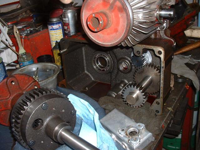

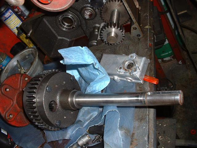

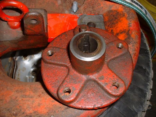

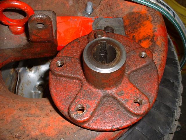

Here is the inside of the transmission. The key of the left hub is almost cut and the hub keyway is broken. I have decided to make another and longer keyway. This shaft is made from a very good steel since hardness = 55 Rockwell C. This is the reason why the problem is in the hub. The shaft seal is no longer available from Toro. This is a 1.500" O.D. and 1.000" I.D.

Robin....The 4 speed 'manual' trans with 1" axles take a Napa NOS 9815 seal. Maybe it is the same as the hydro. Try to keep that open auto trans in a very clean area. The oil goes directly to the pump/motor from there and then through the filter on the return (I think anyway). I'd clean it good and place it on some clean sheets of corrugated or something. Don't need any dirt in there...
