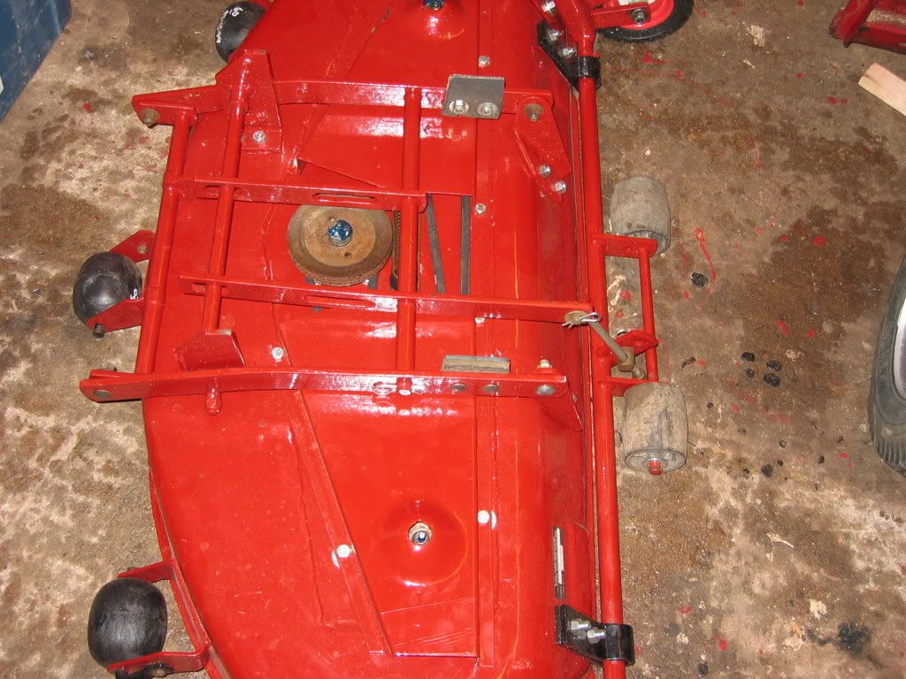

heres the home mede version,the whole top of this deck is now 1/4 or 5/16 plate(cant remember what gauge)the top was so cracked and soft,no rust just over used,i cut the whole top out and welded the plate in and redrilled all the holes,including the 2 1/8 spindle holes,this deck is so smooth now,no vibrations at all,and it just cut great too,but its retired for now as i re did her and havnt used it in a few years
