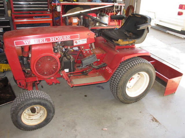

Hi everyone,
Was wondering if anyone knows the size of the front wheel bearings for my 1976 Wheel Horse C160
tractor. I am not near the tractor but am heading where it is next week...the front bearings are tired!
Wheels are stock 16x6.50-8 (tires).
Any help would be great, I'm guessing Grainger will have them, or my local John Deere Dealer.

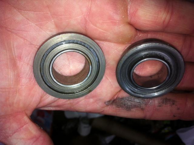

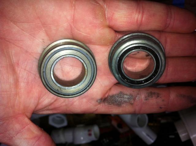

Hey Gents,
Went into a local Toro repair store, you know, those old shops that are loaded with
old stock...this old fellow had bags of them. Thanks again for the help, they fit perfectly.
Jason
