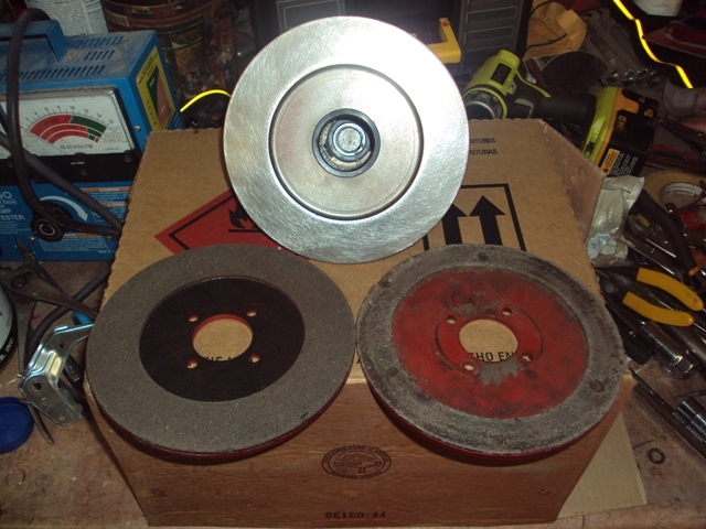

bowtiebutler956 649 #4 Posted February 19, 2012 Yes Mike there is, I meant to take a picture of the lining of the old and new clutch side by side to show how much more the new one has, but somehow I forgot. I will post a pic of that tomorrow. Matt Share this post Link to post Share on other sites
bowtiebutler956 649 #5 Posted February 20, 2012 Here are the pictures that show the difference on the amount of clutch surface area between the new replacement and the original. It's a big difference! Should have alot more holding power. 1 Share this post Link to post Share on other sites
