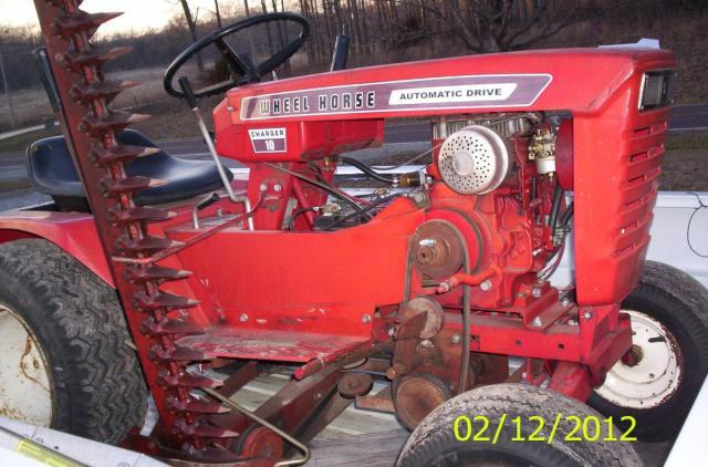

Posted 12 February 2012 - 08:55 PM
My lastest WH!

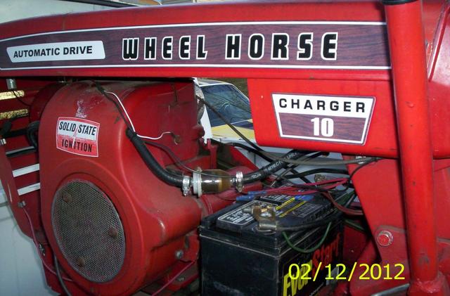

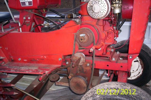

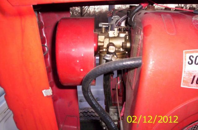

Got it unloaded Sat. It has some issues. The throttle cable is broke, it doesn't want to move too good, there is a valve on top of the transaxle that is adjustable so I need to read up on that. When I engage the transaxle the belt sound like it is lose and slapping the guard. Starter sound rough. I will read up on the adjustment valve, check out the belt first. Don't have time to work on it right now, so it will have to wait for a week or so.....the engine sounds good just can't get the throttle above 1140 rpms.....

If it doesn't want "to move too good", the tow valve (on the transmission) may be open. This valve is used (open position) to move the tractor with the engine not running. If the engine is running and the valve is open, the fluid is being "by-passed" and not channeled correctly to move the tractor.

I'm new to the older hydro transmission too, so this might not work for you, but mine has a 'tap' on the top of the box which is the tow valve.
It operates through 180 degrees, drive- positive/tow-free wheel. Hope this helps. :thumbs:

Thanks farmer. so the valve only rotates from 'tow' to 'drive' and does not have threads on it. Guess what I am trying to say is that is just turns 180° to change from drive to tow?

That's right. There is a pin though the adjustment rod. Point the long end towards the front of the trailer....that is if the pin is set right...to engage the transmission. Point it backwards to release it.
