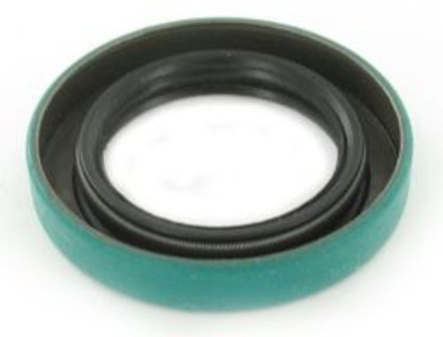

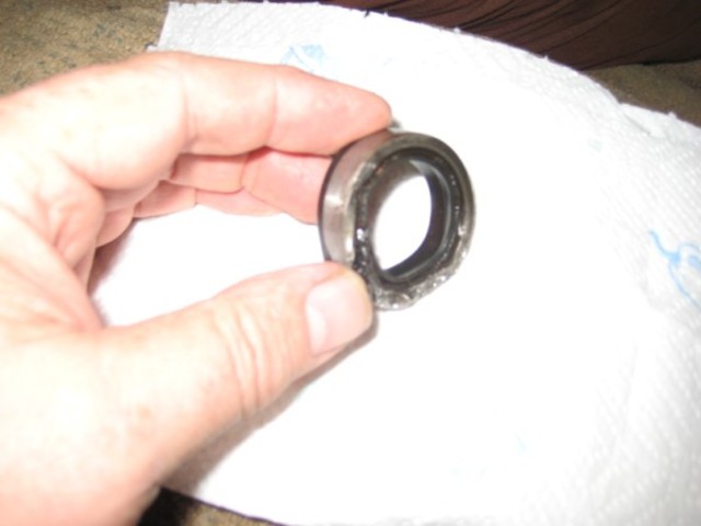

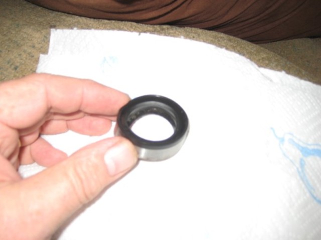

My 876 blew out one of the axle seals and through research I discovered this thread. I used the SKF cross ref for original seal #5958 which Toro crossed to #100607 and the SKF crossed to #9878 which I can get through NAPA. Thats great and thanks for the info but, in looking at the specs for the 9878 seal it doesn't appear to match the seal I pulled out of the 876 HST.
The seal I pulled out is much wide than 0.25
I'm going to attempt to attach a couple pics of the seal I pulled out. The replacement seal appears to be too thin and is constructed differently.
Theres a front and back shot of the original seal and a shot of the seal thats listed on NAPA's site.
Rekon napa's pic isnt a good representation -or- i shouldn;t woirry and go for it?
Thanks
Dave
Newer seals always seem to be thinner than the originals from many years ago. On my old farm tractors there is enough room to put in 2 modern seals in place of one 50 yr old seal. (which I often do, better sealing and it can get the new seal lip riding on a different part of the shaft from where the old one wore a groove.
If the new seal is the correct OD and ID I wouldn't worry about the thickness.
