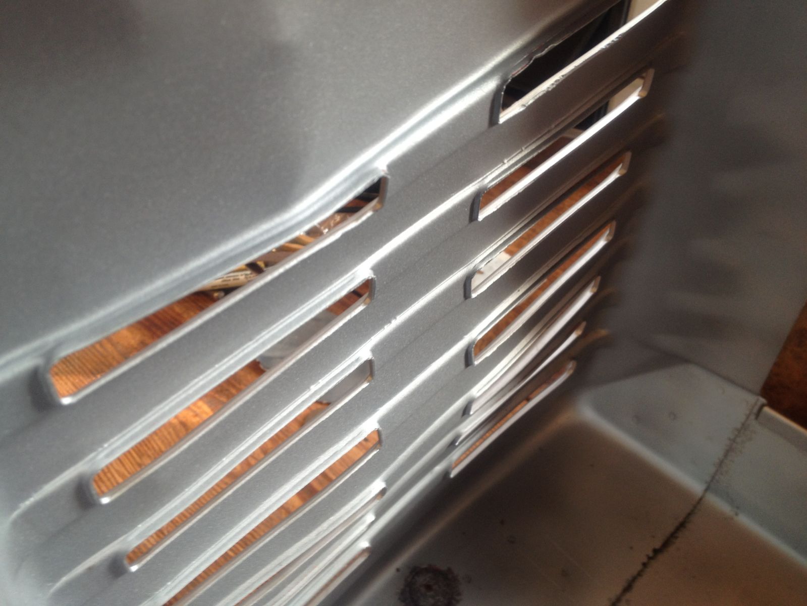

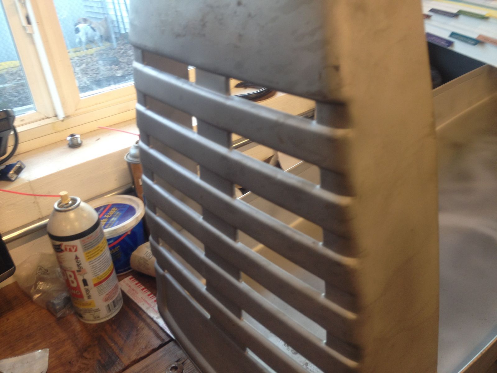

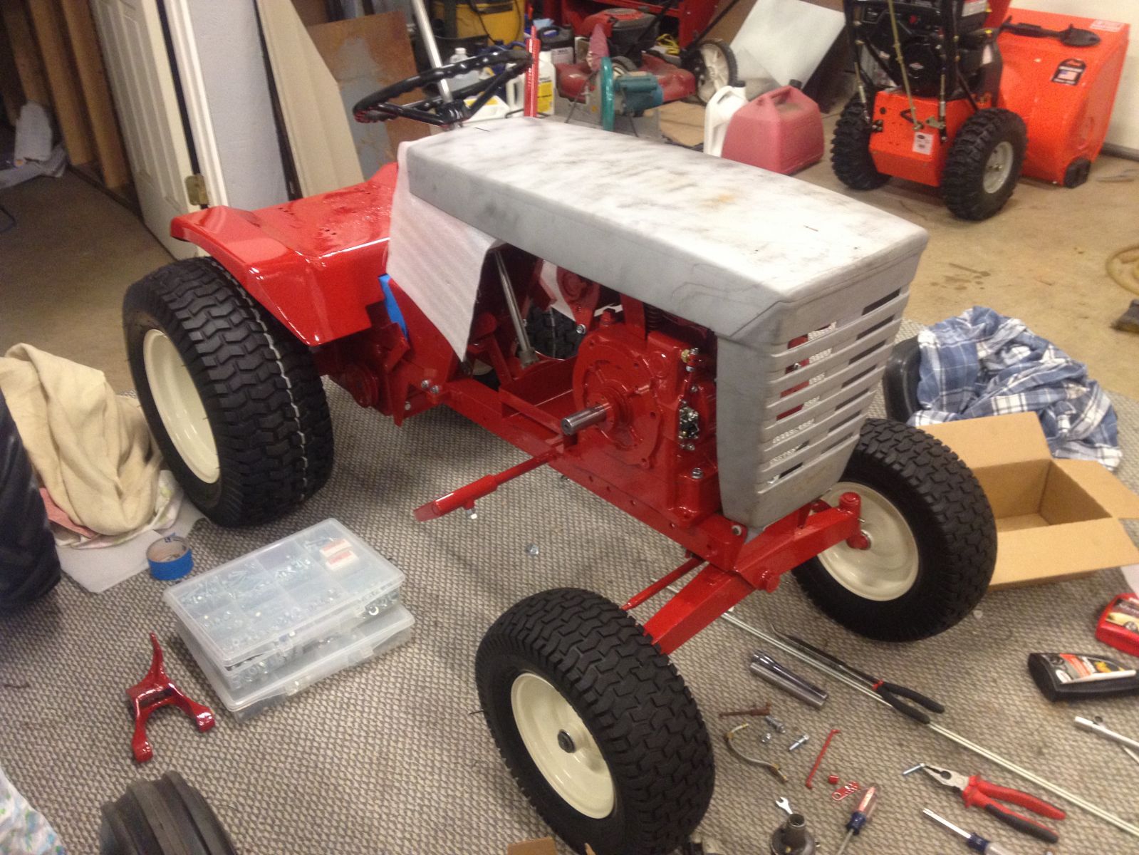

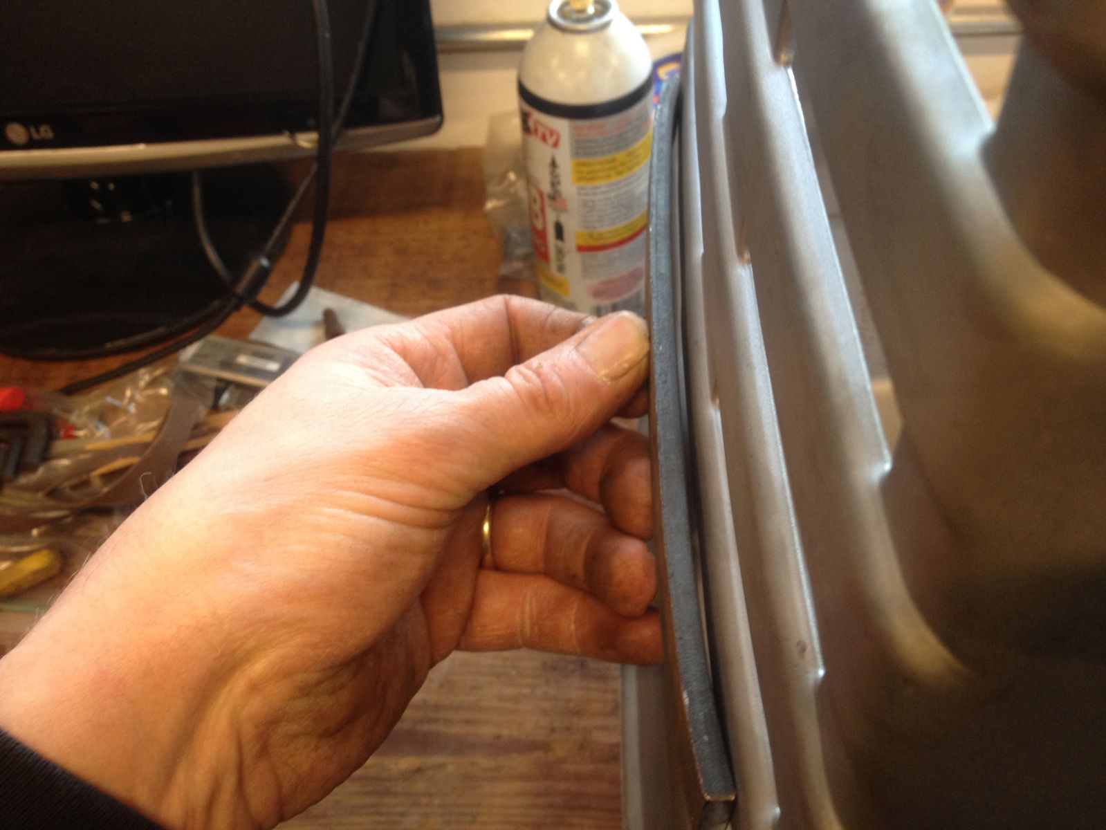

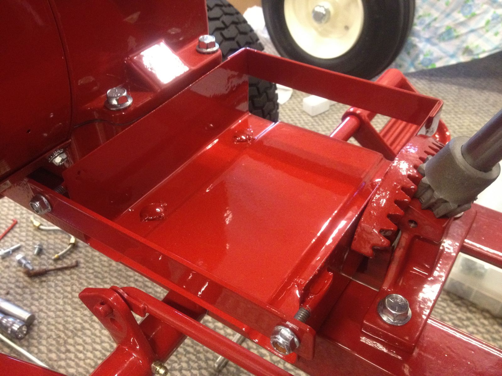

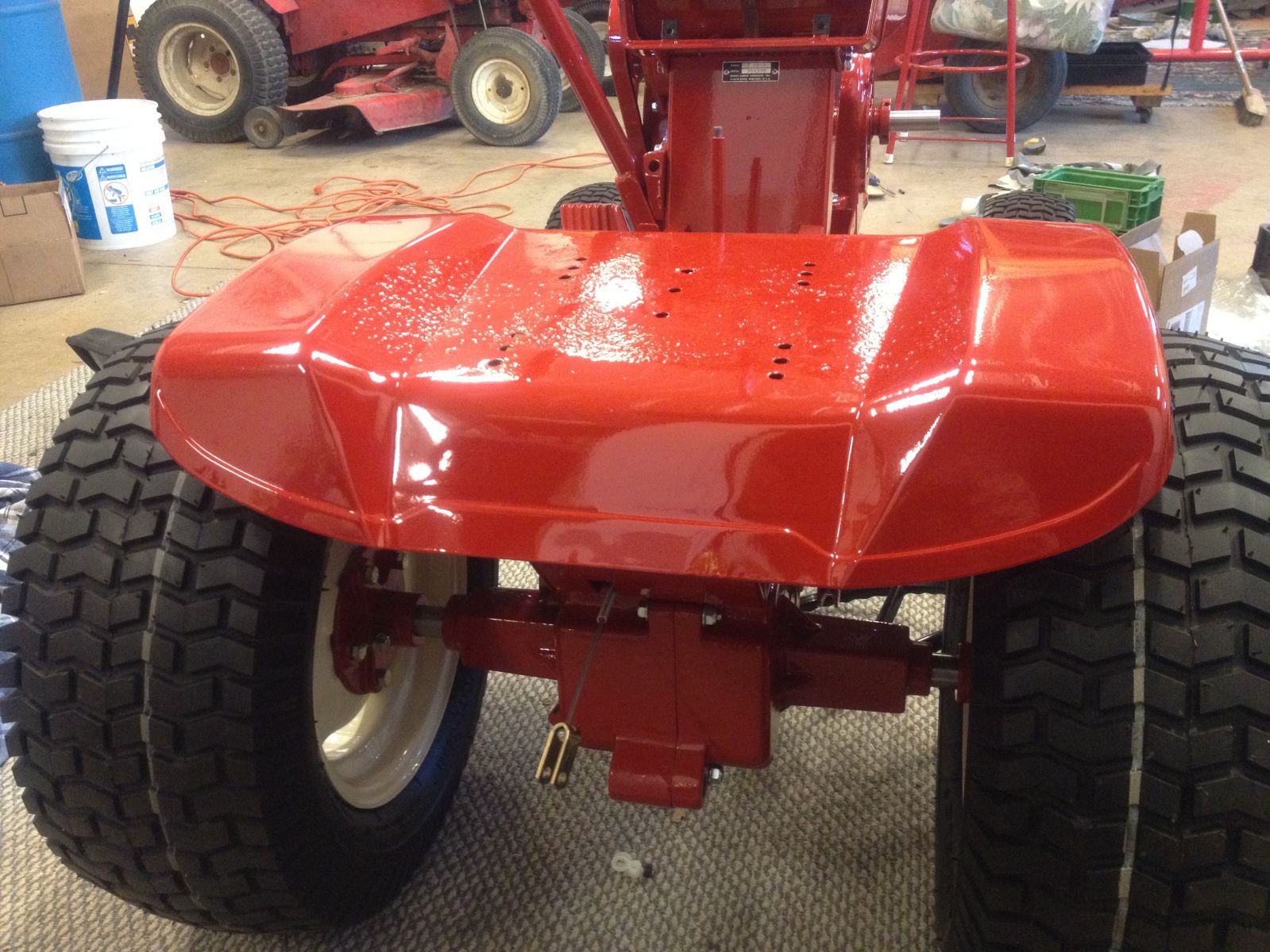

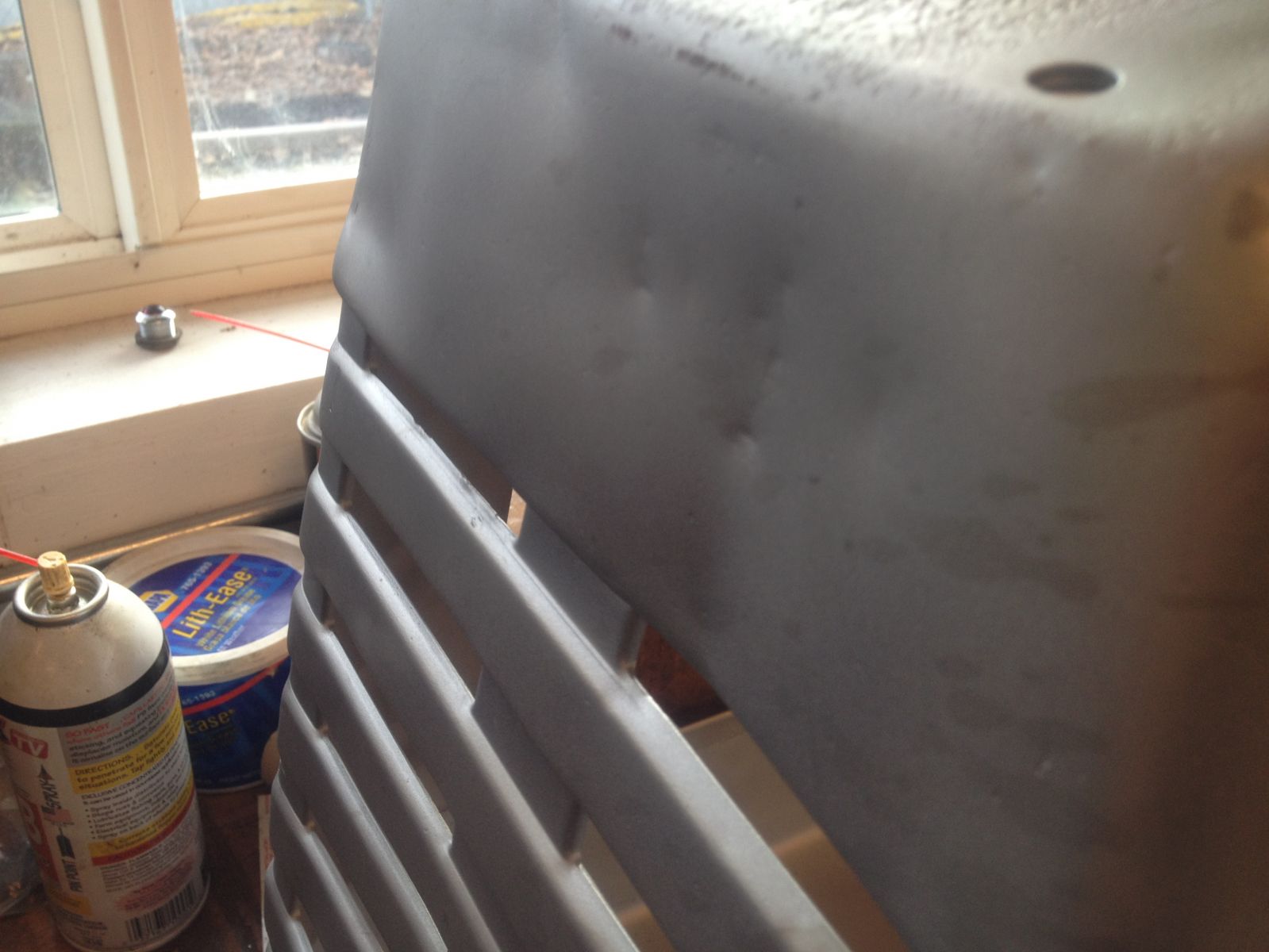

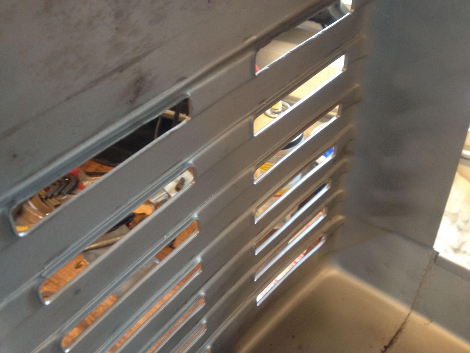

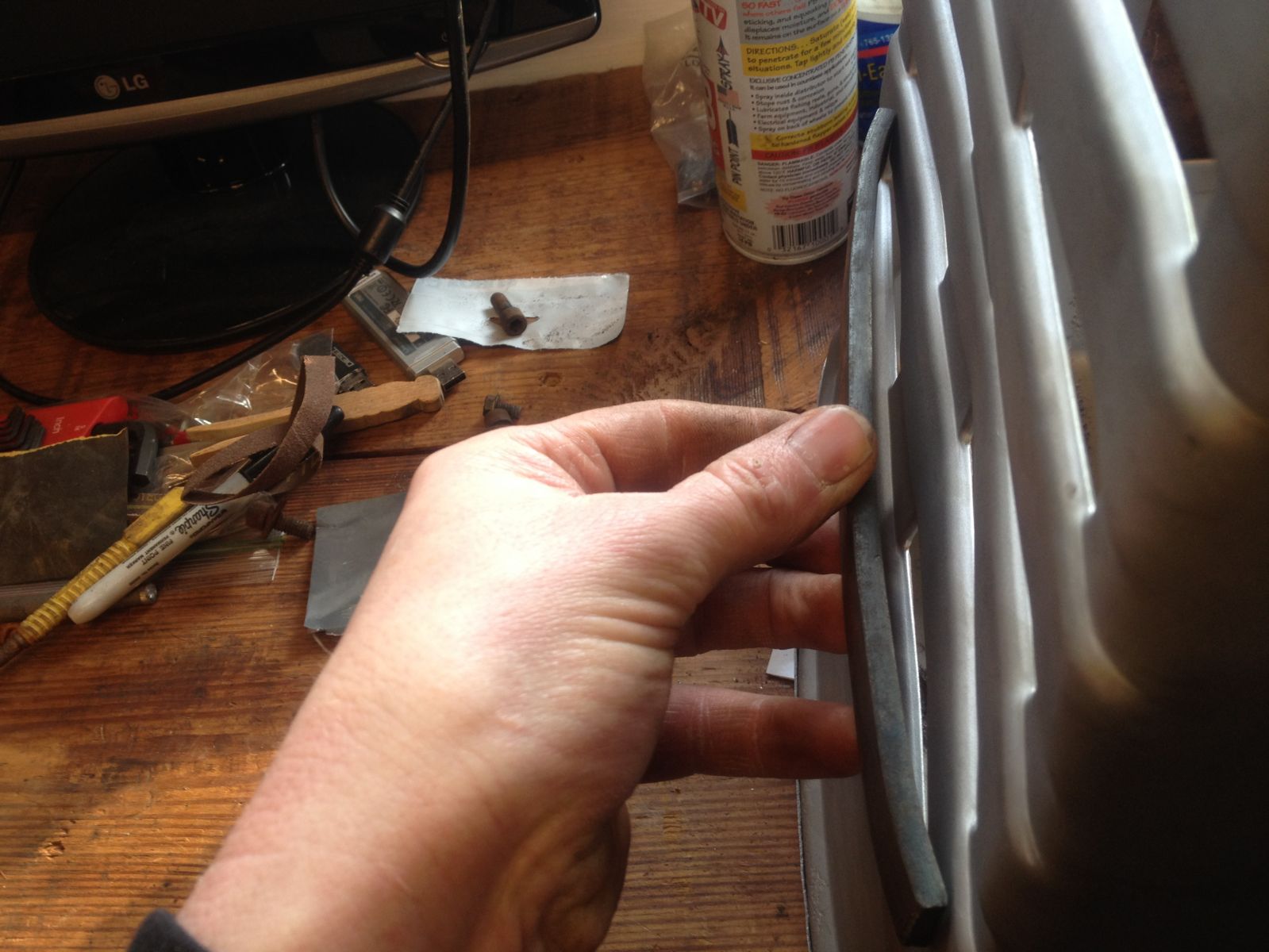

Martin 2,130 #88 Posted February 4, 2012 been working on it a little through the week. got the first coat on the seat pan, still needs a bunch of work in the center section where the seat is mounted. its basically all covered by the seat but i would like it to look a bit smoother than it does now.most of the exposed areas are almost there, just a few areas with really small areas of surface pitting to work out and the odd small dent. wanted to make sure that it fits well before spending a bunch of time making it look better. still learning on the whole multiple coat thing with powder. its a whole different animal than wet spray. also made a start on straightening the hood. it wasnt ever fitting well before and looked like somebody had been ramming into things head first with the tractor. i bent up a piece of flat bar that would fit behind in the slats to the profile of a good grill (my 875 has a nice straight grill, so it was a good pattern). then went about straightening by beating on the bar with a hammer spreading out the blows to slowly work it back into shape. the grill has a slight curve so i had to try and get it out more in the middle to get it looking right. some of the before and the piece of bar...... an idea of how out of shape it was. i put a tighter bend on each end of the bar so the ends wouldnt put marks in the metal while it was getting beat on. getting there, lower part needed some more dent removing ..... back side. the best part about using a form of some sort is it hardly marks the metal, if you were beating on the metal itself there would be a lot more marks to fix once its straight... looking better now, now the grill is close to the curve of the form. major work done. still needs some minor stuff and some cracking fixed and reinforced where the upper hood and grill meet. seeing how it fits...its almost looking like a tractor again..... also got the tank and battery tray done. thats all for now..... Share this post Link to post Share on other sites
Jake Kuhn 1,547 #89 Posted February 4, 2012 It looks great Martin! :handgestures-thumbup: Share this post Link to post Share on other sites
WH4ME 6 #90 Posted February 4, 2012 Looking good Martin! Share this post Link to post Share on other sites

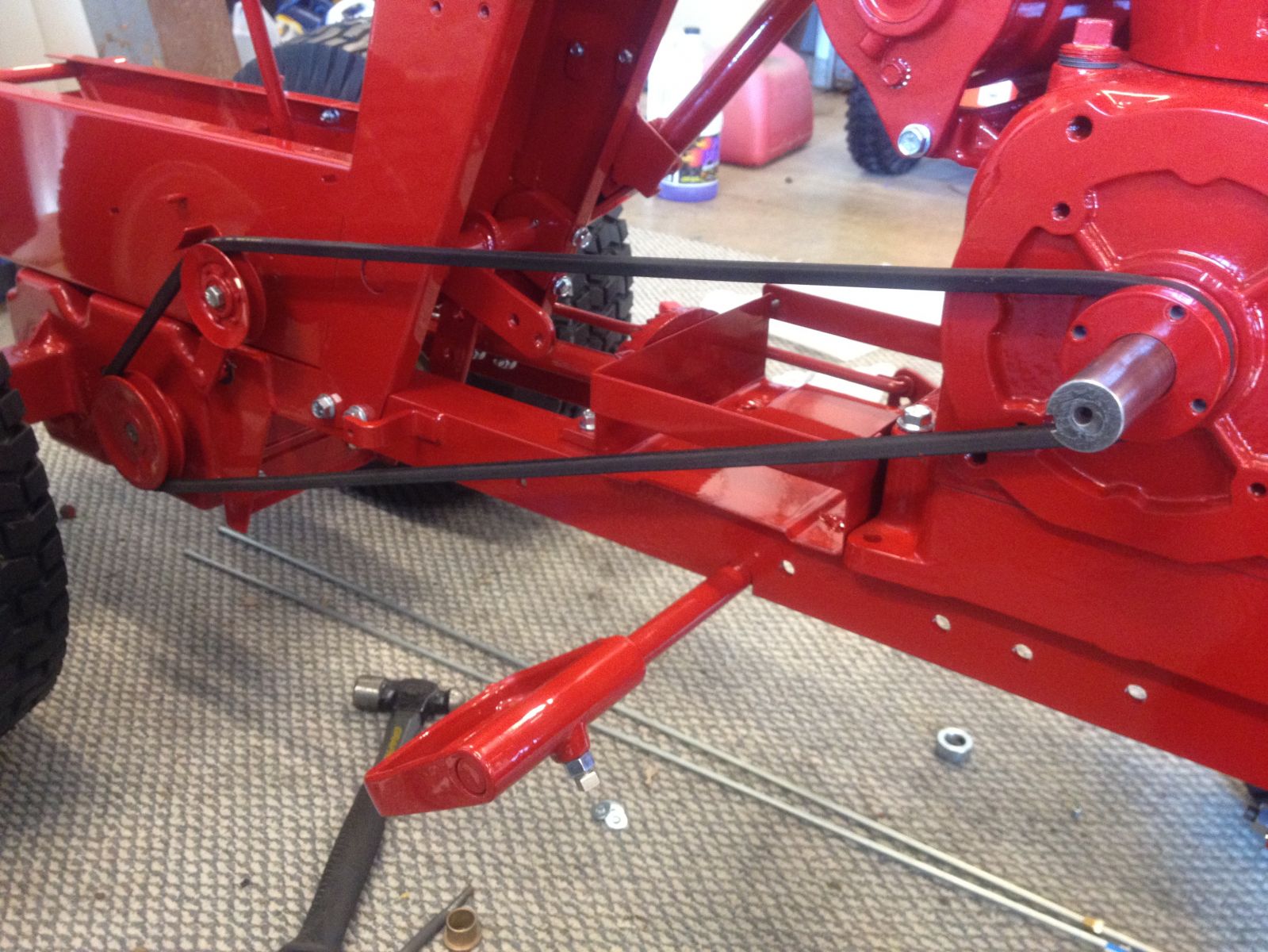

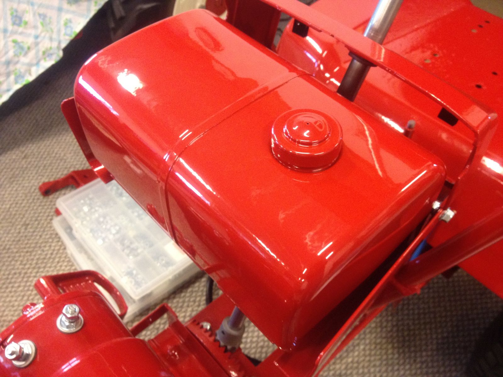

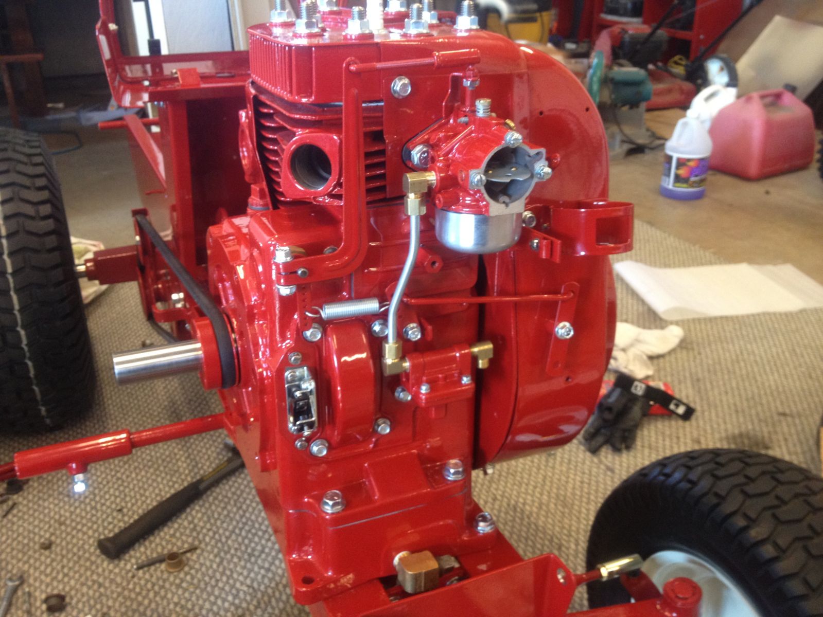

Martin 2,130 #95 Posted February 5, 2012 made a little more progress in some things. got all the carb/governor linkage painted and on, coil and choke bracket done, actually most of that end of the engine is now done other than the points wire and coil, and fuel line from tank to pump. also got the drive belt/idler done, cleaned up the old belt as its relatively new. not sure about new throttle and choke cables, heard some problems with the throttle knob twisting off after limited use, need some input here on what to get, i dont have any good used ones so i need to buy new, are the toro ones any better than the stens ebay ones? thats my biggest holdup now with the dash. got a new ignition switch and gen light. these things cost a little more than i really would like to pay but they are new and ready to go. the ignition switch is the heavy duty one that came on these tractors (used without a solenoid) and both of them are cole hersee products, which they originally came with. ended up using the cig lighter insert from my 875 as it looked correct and was in really nice condition, just needed a good cleanup and polish.. cleaned up the outer from this tractor and painted the shield/ nut red. 4 Share this post Link to post Share on other sites
