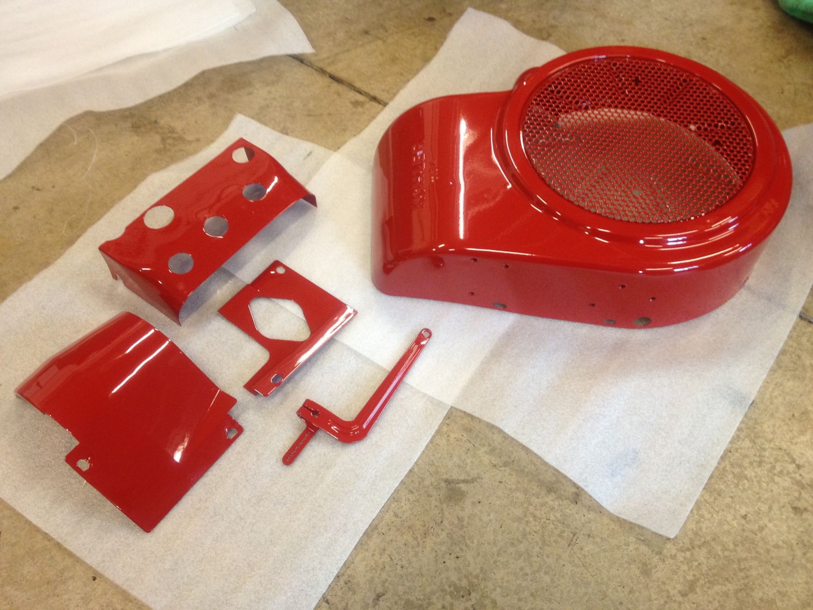

painted a few more parts. i had a k301 with a later starter setup and decided to use the tins from that for this engine. its got a later c series oil pan already so i thought id keep it around the same time frame. it was a cub engine originally and is going to be used for a special project (thats still going around in my head at the moment). will be used with an 8 speed i recently picked up as well. anyway heres a pic of the tins.....
