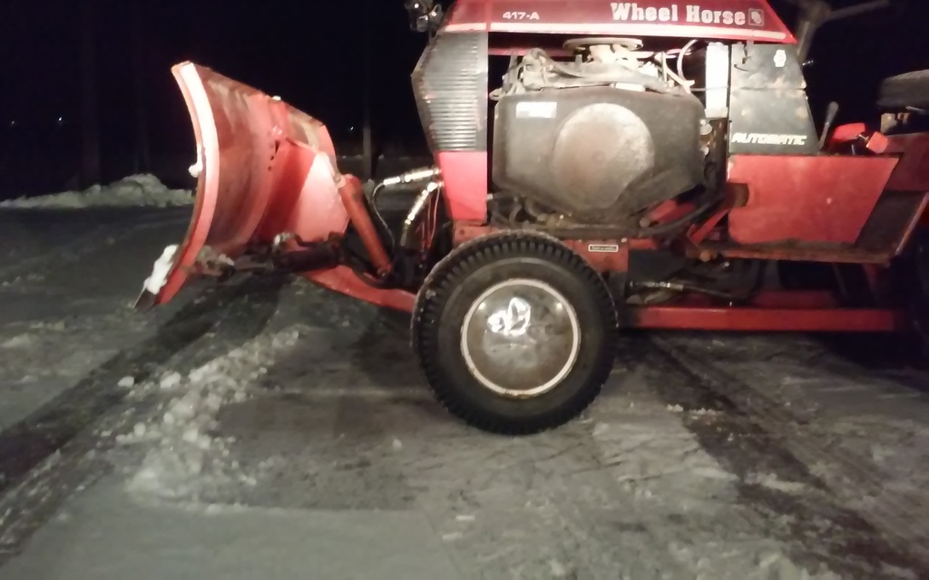

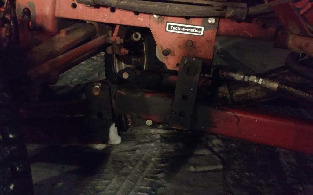

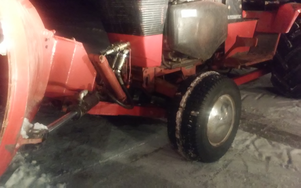

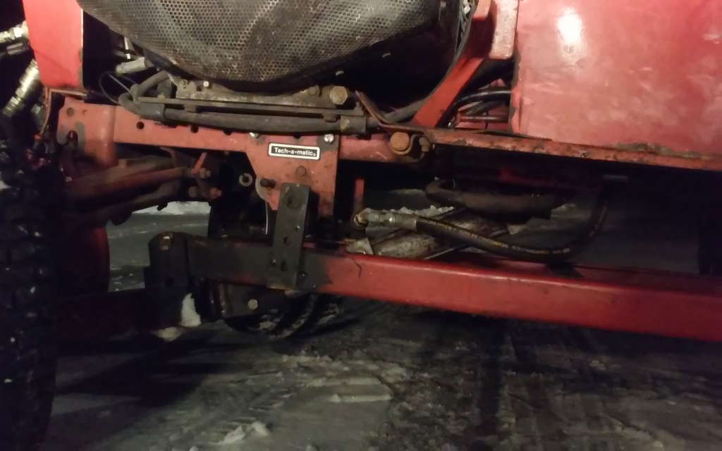

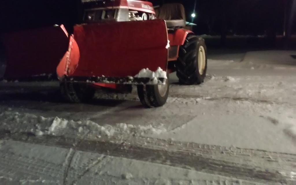

smoreau 647 #64 Posted February 1, 2017 I have to say that this blade has worked great for the last few years, but....... Those that know me now I can not leave anything alone! The big issue that I have had is the blade sticks out farther then a stock blade and on small hills and uneven ground it would dig in and leave a divot in the grass. This was getting very annoying filling them back in all the time. So this winter I decided to fix this issue by making the pivot point for the V blade farther forward. This required some thinking because I didn't want to loose ground clearance or the rigidness of the A frame mount of the blade. Best spot to do pivot the blade had to be around the mid teach-a-matic. So with a spare deck mount and some steel, I mounted the A frame to the mid tach at the same height as the rear tach. This should also make the tractor frame stronger were the notorious cracks happen were the trans mounts. Next cut the A frame and make some drop down pivot mounts. Mount the new larger cylinder and run some new lines from the lift valve to the larger cylinder. I did try and use a snow blower flag and tube at first, but the angles didn't work and it wouldn't lift the blade. This blade never comes off this tractor as I need it on there on the summer for counter weight for the 5' landscaping rake I mount on the back. Also I use. The blade leaveling ground. now after 2 small snow storms of using the new blade setup, I love it!! It actually does a better job of clearing snow and I can now make dirt piles taller in the summer. Blade goes much higher and now has more down pressure then I had before. Pics to come soon, having issues uploading them. Share this post Link to post Share on other sites
smoreau 647 #65 Posted February 1, 2017 (edited) Day light pics didn't work for some reason, file too large. New pics sorry they are in the dark Welded spots are just painted black for the time being as I was not sure if changes were needed yet Edited February 1, 2017 by smoreau 1 Share this post Link to post Share on other sites
bmsgaffer 1,942 #66 Posted February 1, 2017 The pictures are too large probably because your supporter-ship expired This blade is awesome and I have always wanted to build something like it, and I really like your new pivot mechanism. Have you thought out any other way to lift the blade with the stock cylinder? For those of us that may need to swap out the attachment? What about a pivot mechanism just below the rock shaft that can turn down-force from the rockshaft into blade lift? Have you considered moving the front hydraulic lines to get a little higher lift? Thanks for sharing this! And one more request, could you youtube a video of it and post it here? I just love to see these creations in motion. Share this post Link to post Share on other sites
