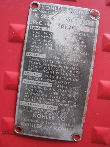

Does anyone have a decent pic of a spec/sn tag from a k161? I want to see if Terry can make a new decal for mine but I want to make sure the little boxes the numbers are stamped into are the correct size. It's hard to tell looking at my tag. Any ideas on where to buy a new piece of aluminum to use as a backing plate for a new decal? This one measures about .023 thick.
The condition is not much better than your's Denny, but here's my contribution to the cause.
Click on the image to enlarge.
post-3498-0-65481000-1338118248_thumb.jp
Thanks Craig, that helps a lot. :thumbs:
  • Like 1
I have a good picture for you. I can get a better one tomorrow. This is a K161 off a cub cadet.
Thanks CRE1992, I think I have the info I need from the pics you and Craig have posted. I appreciate it.
Denny , try this guy for the reproduction brass plates , ive seen his work and is is real good quality , not sure what the cost would be to have made but it would be a superb replica for sure
Hope this helps
http://www.vintagebrassplates.co.uk/
