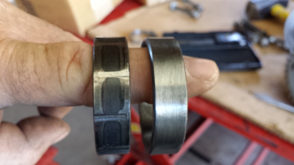

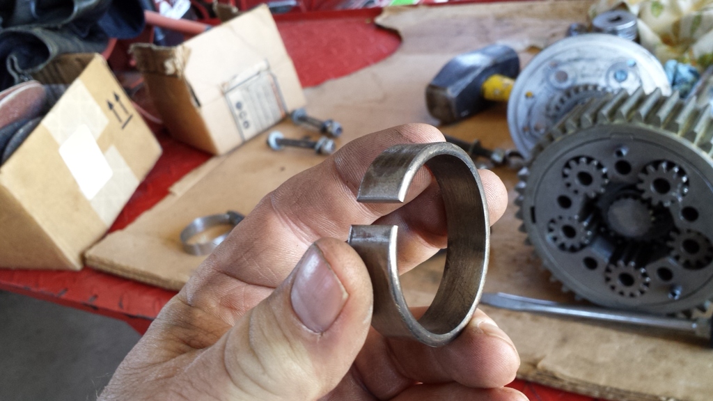

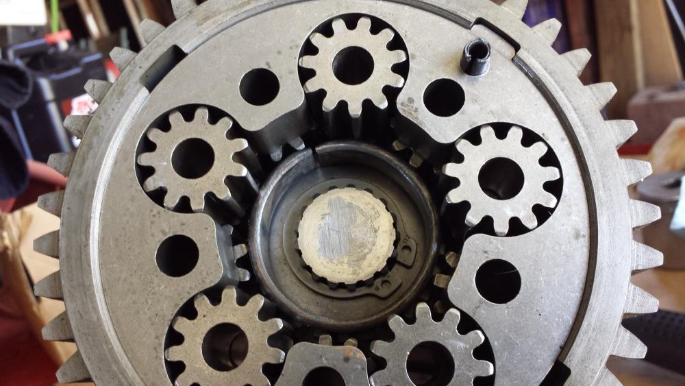

When turning the rear wheels while both are off the ground, be sure it's in neutral, or it will differentiate and the wheels will spin opposite of each other. One might even hear a "clicking noise", that's the radial spring bouncing on the pinions. The ten pinions in the hydros, you would have to get the hydro motor to spin. I don't think releasing the tow valve would help, simply because there is still a lot of resistance. Here is one I made from spring steel order from Grainger.... Pretty ingenious really, but not as strong as the 8 pinions.

How did you get the pring steel bent so nicely??  You should make a few I would buy a couple right now..  I really like the LTD slips 10 pinions.
Posted (edited)
I had to first anneal the stock to make it workable... cut, grind, measure, heat, beat,cut, grind, measure, heat, beat , then heat treat. Red hot dunk in water then brought up to about 450-500 degrees and air cooled to temper.:twocents-02cents:
