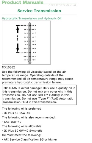

Aldon 4,826 #32 Posted October 7, 2015 It is hard to find anything specific. For the most part any oil seems to be ok depending on extremes of environmental temps one might work the Hydro in.I was able to find a JD manual that allowed 0w-40 synthetic. Share this post Link to post Share on other sites
